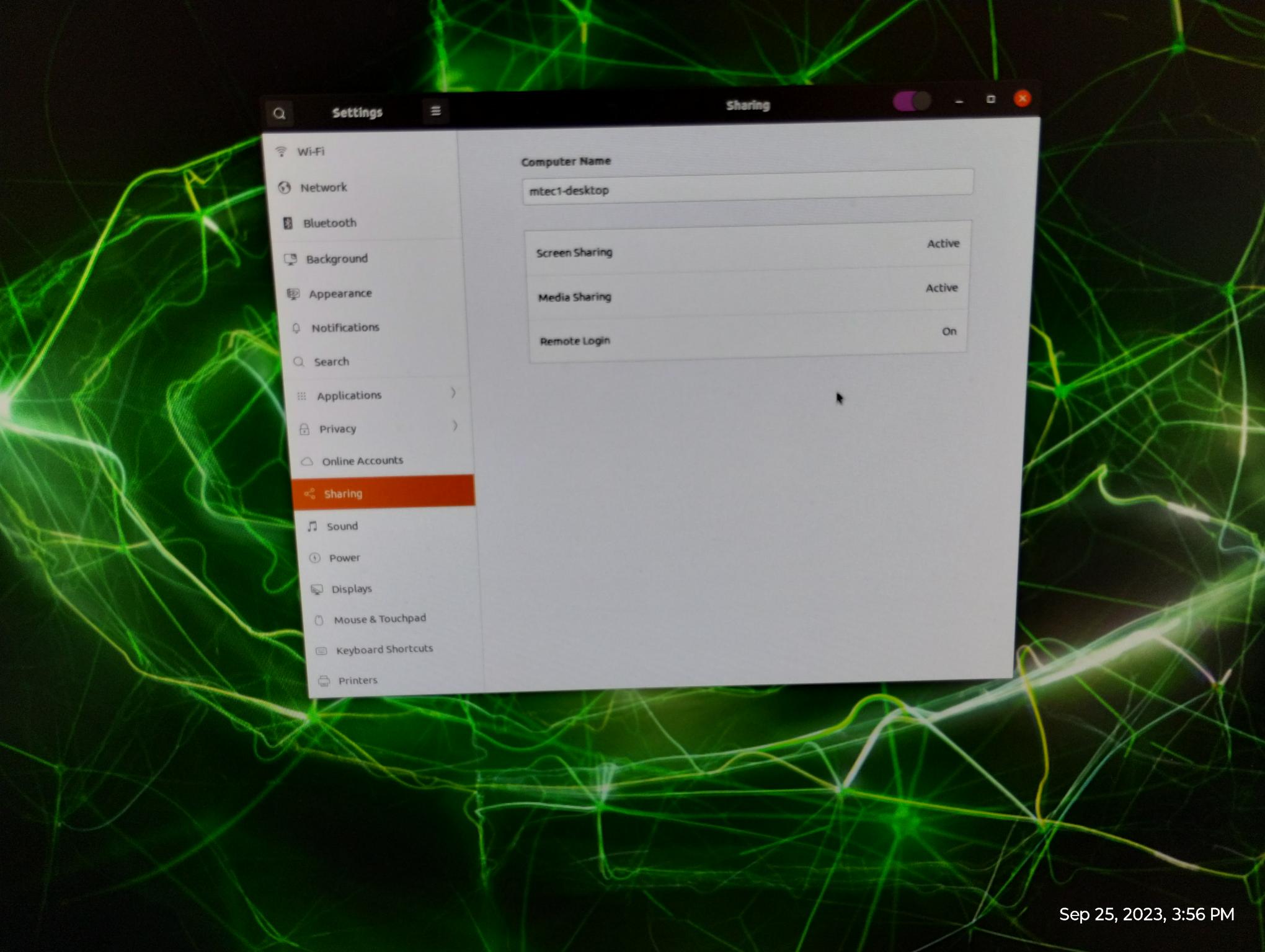

I have a new Jetson AGX Orin dev kit. It is connected to a monitor, keyboard and mouse via a KVM. Jetpack was used to install all needed software and system works well.
I am able to do most tasks via a SSH session, however, I have a few tasks I need remote desktop access.
I followed the instructions on this page: trying to connect to it via a and have installed RealVNC on my remote laptop. My colleague in the office shared these screenshots, confirming OS Sharing settings:
However, when I run RealVNC on my remote system to access my Jetson, it times out.
How can I fix this? What am I missing?

Hello. Thank you for reply. Below are answers to the questions and some extra information.
  • I am using the NVIDIA dev kit.
  • Jetpack info:
    Package: nvidia-jetpack
    Version: 5.1-b147
    Architecture: arm64
    R35 (release), REVISION: 2.1, GCID: 32413640, BOARD: t186ref, EABI: aarch64, DATE: Tue Jan 24 23:38:33 UTC 2023
  • Before running RealVNC I ssh into the machine and run the following commands:
    systemctl --user start vino-server
    sudo netstat -tulpn | grep LISTEN (to confirm the server is launched )
  • I have tried VNC Viewer. I am using
  • My AGX Orin board does connect to and display on a physical monitor.

Thanks for the additional information.
At the moment I cannot update with latest JetPack. The system is in use and needs to maintain its configuration.
I have, however, done the extra steps you suggested.
Here’s what I see when I execute: systemctl --user status vino-server.service
Here’s what I see when I execute: netstat -an | grep 5900
I tried a down rev version of VNC Viewer (v 6.22) and had same time out error:
Based on the first two screenshots, is the vino-server IP addr incorrect? 0.0.0.0:5900
Also, port 5900 is not blocked in my local network.
