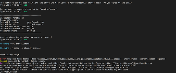

I just begin to install the Parabicks with the trial installer package, but failed with an “unauthorized” error.
Downloading image
Error response from daemon: Head "https://nvcr.io/v2/nvidia/clara/clara-parabricks/manifests/3.7.0-1.ampere": unauthorized: authentication required
Cannot download Parabricks docker image.
But I can download the image manually with docker pull.

I have several tries, like:
sudo ./parabricks/installer.py,
sudo ./parabricks/installer.py --ampere
or
cd parabricks
sudo ./installer.py
PS: I test on a DGX-A100 Station.

Hi Gary,
I download the latest version, and install it again. But the error is the same.
Hi @gburnett ,
The “Unautherized” error is passed by used specified intallation director option “–install-location” .
However, now there this a “GPG error”, which I think is related with recent GPG repository updateing and still not be managed now.
Hi @lkuang ,
We are working on pushing a new package with a fix for the GPG repo. It should be out very soon. Thank you for your patience.
Hey @lkuang ,
The new version is up on NGC and you can access it by downloading the most recent version.
Thank you.
