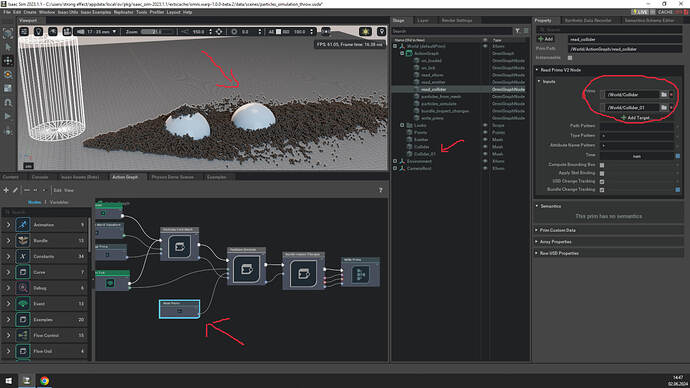

Warp How to add a two Collider object
Why is Collider_01 not affected by particles?
Hi @strongeffect.uz, currently the Particles Simulate node only reads the first collider from the Read Prims bundle.
These nodes are mostly designed as examples of how you can create your own simulation nodes, and I am not sure when we will update the nodes to support more complex inputs sorry.
