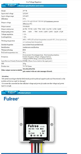

This is the convertor used, the sellers say this is non-isolated buck converter and there are isolated ones which are used in radio related devices for less noise, does this have anything to do?
Hi, if no such interfere with other power supply as you got in lab, then it should be the DC-DC problem. You can try other DC-DC, or adding a big capacitor between ‘+’ and ‘-’ of output of DC-DC. BTW, in your picture, why do you connect GND of nano board to the GND of input of DC-DC?
      Thanks, I will check with an isolated DC DC Converter.
     We shall try that, I see new capacitors on the new Development board. Will these help stabilize the voltage levels ? Do you know why are there added?

In theory more caps should be better for it, but not sure how better it could be. So still better to try external big cap.
