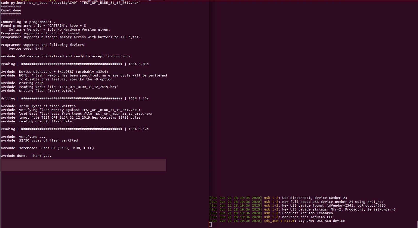

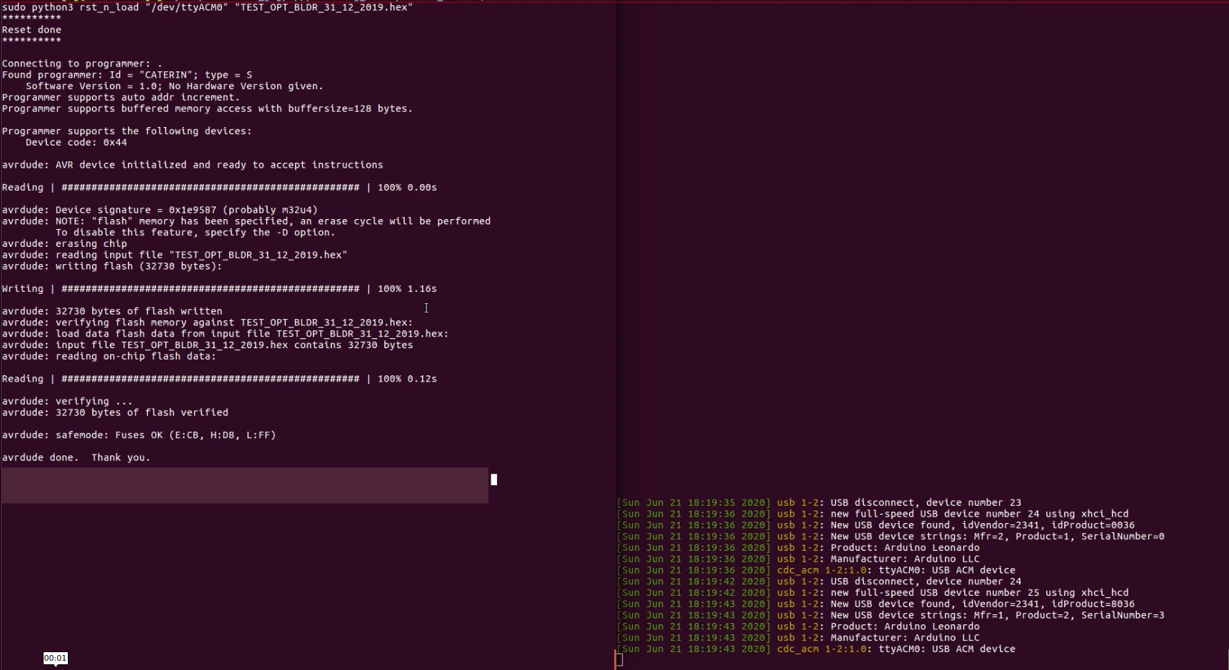

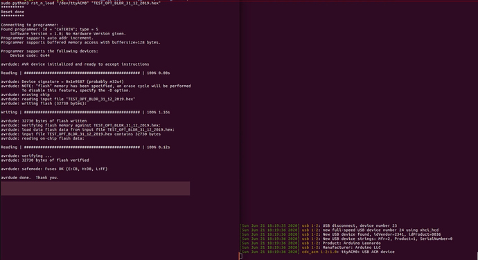

I am urielom8ug teammate, I upload here the flashing output on the left side of the pictures and the dmesg log on the right side of the pictures, 3 pictures are from working environment (x86) and 3 of them are flashing from Jetson TX2 [4GB] with Jetpack 4.3 that don’t work.
You can see on the “working pics” that after the reset to flashing mode the flashing is started and after the flash success there is another reboot where the arduino come back with the same ttyACM number.
On the “not working pics” you can see that after the first reset to flashing mode the flash running get stuck and then the board make a reboot to data mode in different ttyACM number, and the flashing stays stuck in the same place.
I hope the issue is more clear now.

Working 1
Working 2
Working 3
