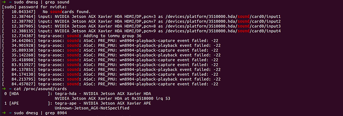

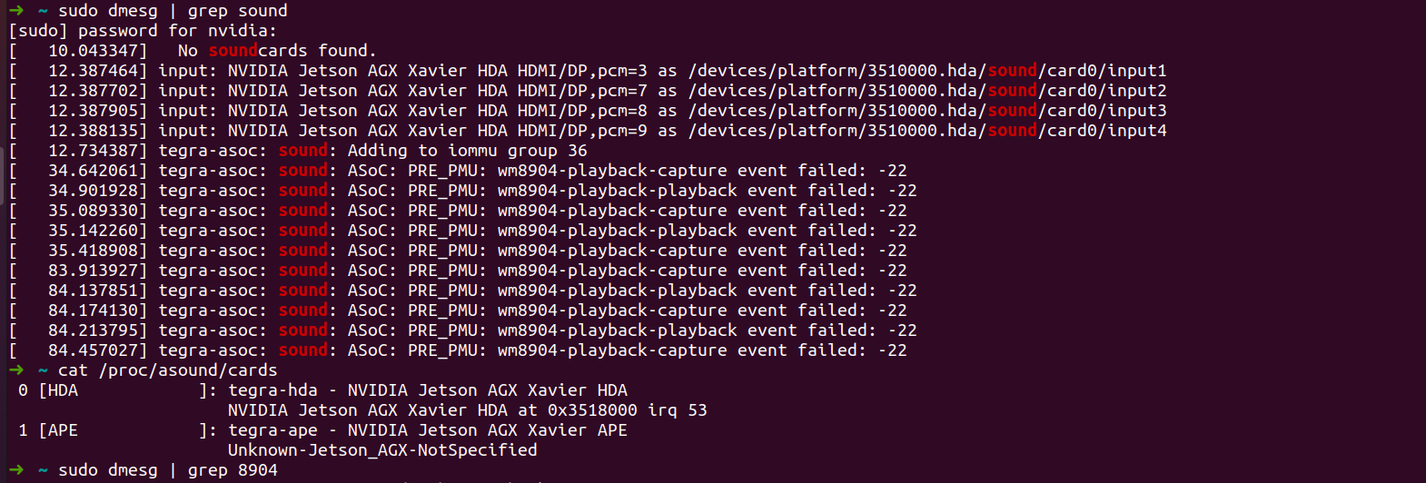

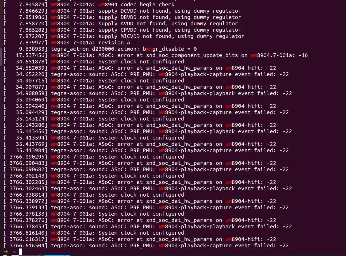

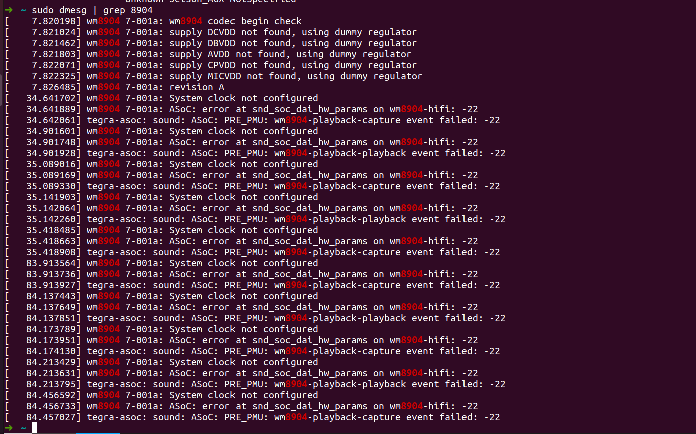

@Yolomei ,Dear Yolomei ,hi,I feel like I’m about to get it done, now the kernel is printing new errors, can I help take a look?
Here is my modification of the tegra194-audio-p2822-0000.dtsi file,
Really thank you very much, I can’t get it without your help, really appreciated

This is my current device tree configuration
This is the dmesg log

but dmesg shows [34.651878] wm8904 7-001a: System clock not configured
Please share the list of changes you are doing along with
dmesg logs and output of sudo cat /sys/kernel/debug/asoc/components
As there is no response further, please let us know if the issue is resolved.
Yes, the voice is already available, thanks
Thanks for the update.
Please update the solution also and close.
I solved the “wm8904 8-001a: System clock not configured” alarm, but there are still the following alarms, but it does not affect the sound
“tegra-asoc: sound: ASoC: CODEC DAI wm8904-hifi not registered”
