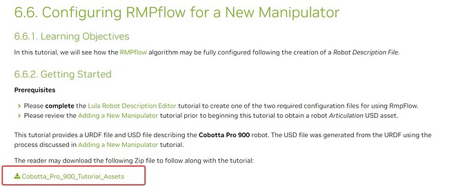

Hi everyone, I am trying to test RmpFlow using a cobotta_pro_900 robotic arm. I used a tutorial case where “end Effector” is “right-inner_finger”, but I encountered a strange problem where its execution was accurate when it approached “baseunlink” (or close to cobotta_pro_900 itself). But when he is far away, he will have a very large margin of error. It seems that calculations can only be carried out within a certain range.
I also tried Frank and customized a robotic arm (which has no axis restrictions and is completely free). Even if the robotic arm is very long, a similar situation occurred. It always accurately executes the “Follow Target” within a certain range. If it exceeds the range, it will be inaccurate and the range will be very small.
I want to know if there are any parameters or method adjustments. It is very important to me and I hope to receive everyone’s help.
