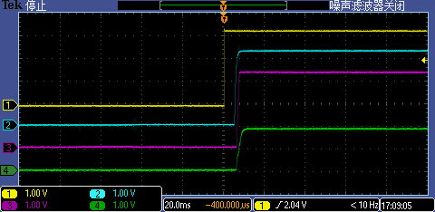

2: Then, I replace another AGX Xavier that has been flashed . After I press the power button, the power on sequence meets the requirements, see the pictures. But the system did not start.
In addition to the power on sequence, are there any other factors that will affect the startup ?
The Oscilloscope has 4 channels, so I upload 3pictures to show the whole power on sequence.
channel 1: BUTTON_POWER_ON*
channel 2: POWER_BTN_N
channel 3: VIN_PWR_ON
channel 4: SYS_VIN_HV (12V)
Sequence1234

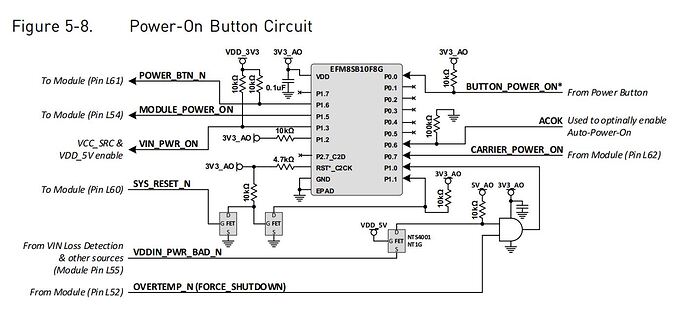

Figire 5-9 in Jetson AGX Xavier Series OEM Product

Is your timing of BUTTON_POWER_ON and POWER_BTN_N correct as figure 5-9?

About BUTTON_POWER_ON* and POWER_BTN_N , I copy the “P2822_B03_OrCAD_schematics”, use the same MCU.
And figure 5-8 is the same.
BUTTON_POWER_ON is pulled up to 3V3_AO(always on) , so once I insert the DC jack, BUTTON_POWER_ON is drived high.
POWER_BTN_N is pulled up to VDD_3V3, so after I insert the DC jack,there is no voltage,until the MCU drive it or after CARRIER_POWER_ON assert.
So,these pictures can prove that theMCU is working and the AGX Xavier module also asserts CARRIER_POWER_ON.
