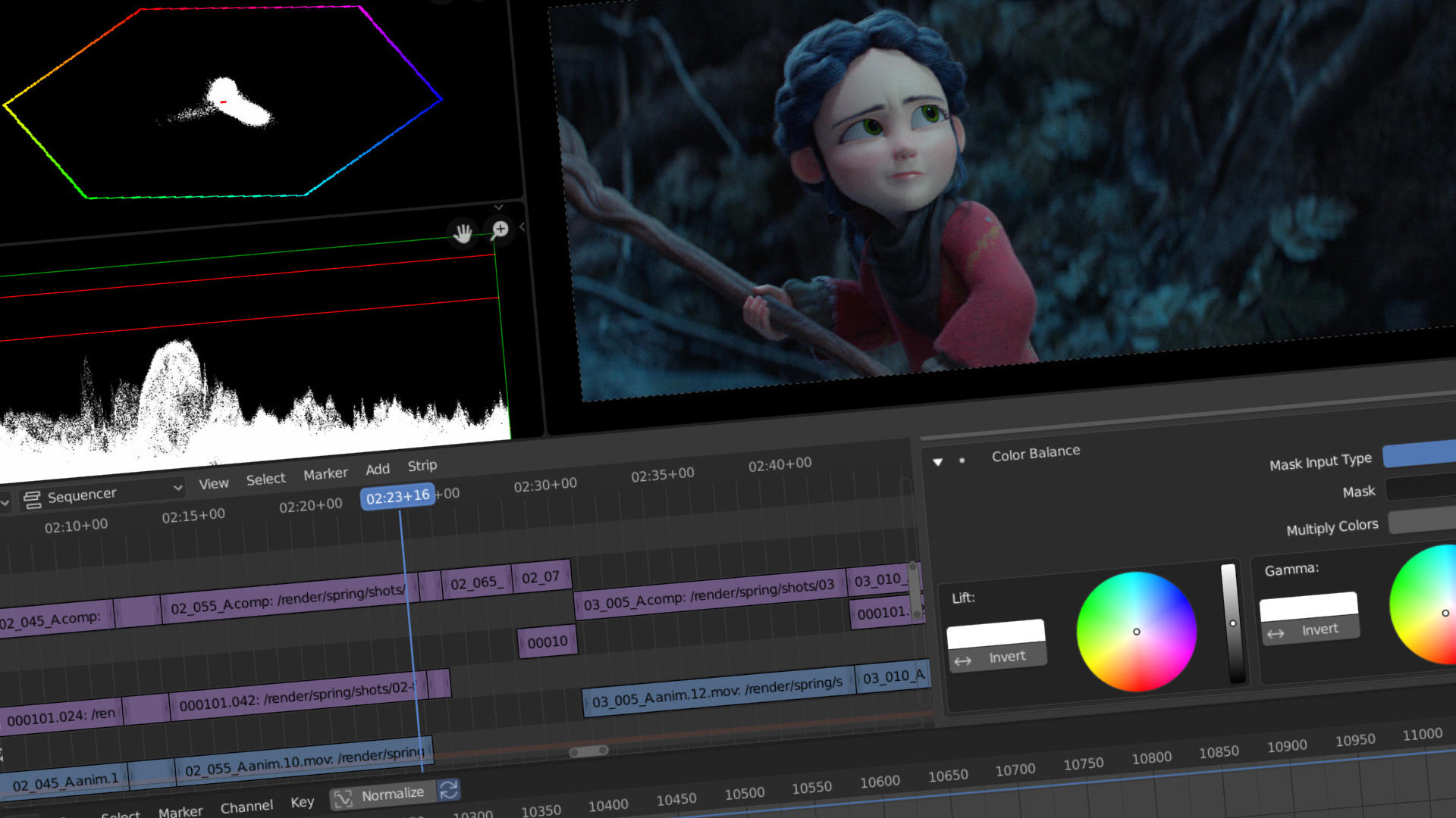

Hey, forget that OpenShot for possible cropping & other post-production.
This is the way yo go, now as Blender is supported too:
