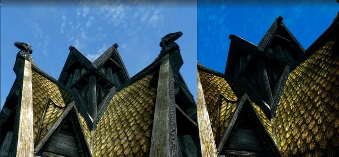

Hi there, to follow up on this issue, I was just testing 3.1.1 and it looks really sharp / good, but we’re not sure if the gamma and colour space issues are fixed yet?
The colours and sharpness look much nicer to me in daytime scenes here, but it could simply be over-saturated. It’s also too dark at night and in dungeons, but it seems much better overall.
Could it be having black crush due to limited → fullrange expansion? Or maybe just the wrong gamma curve / tonemap.
Here’s a comparison of SkyrimVR on 3.0 (LEFT) vs 3.1.1 (RIGHT):
No, we had other critical stability issues that were behind 3.1.1 hotfix release, this wasn’t even on the list. Should be for the next main release. Main issue is whether we can programmatically determine when/why there is the CSC difference in ARCore, and then maybe remove the extra conversion. Also possible there is just a different code path for ARCore (which does the alpha blit) which is causing an incorrect state to get set and handled. Images certainly look like a gamma->linear ‘crush’.
It’s on the list, we’ll review when it comes up on the backlog of tasks.
Hey Dave, I just tried CloudXR 3.2 to see if the toggle helps and it doesn’t appear to be necessary, at least for SkyrimVR to look good. So without using that new flag to force linear (which makes it way too bright), the full sRGB end to end rendering pipeline seems optimal now and my brightness settings were just set too low in the game menu.
