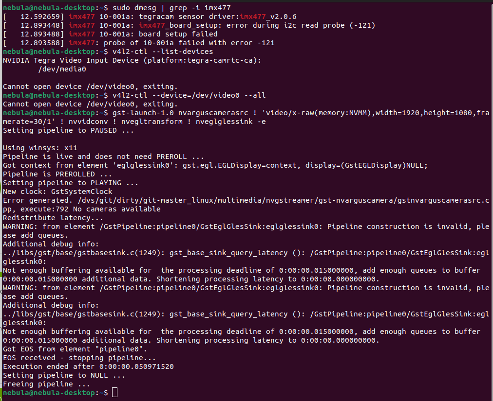

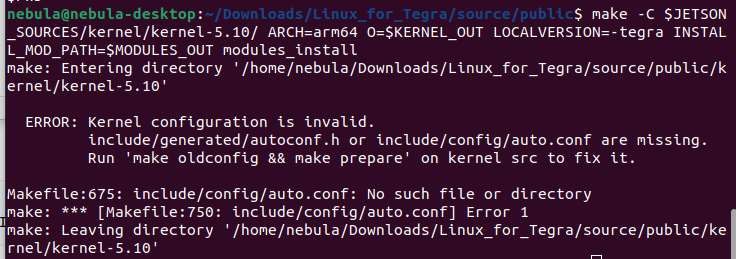

I came across this guide Driver which explains how to setup sensor drivers for Jetpack 5.0.2 , i have a new Orin system that i flashed Jetpack 6.0 into , when i tried to follow the same guide i couldn’t install the drivers and came across a whole lot of problems such as :
is there no drivers for Jetpack 6.0 ? , if so do i have to downgrade to Jetpack 5.0.2
Please use the latest JP6 release and use jetson-io to enable IMX477.

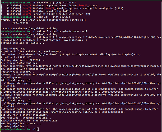

i used jetson-io and configured the 24pin CSI adapter into imx477-A (tried imx477-C too) , then after rebooting , to make sure the drivers are all set i ran these codes which i found on the forums :
is there a process inbetween enabling jetson-io and using the camera which im not aware of ?
thanks in advance
Looks like the i2c communication failed.
You have to make sure the HW design is the same with Raspberry Pi High Quality Camera
The make sure the i2c communicated is necessary.
