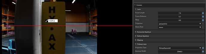

I try to simulate a (real world) rgb cameras. In Isaac sim does the depth of field not work properly, nothing is sharp at all. I found out that depth of field only works with pinhole as projection type (which is fine) but the result is not what it should be.
I use the following parameters (which I have from a DoF calculator):
Here my settings of the camera:

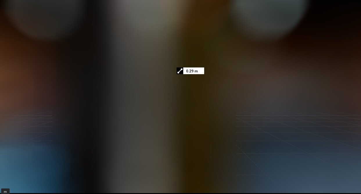

The resulting image is then:
The distance is measured from the camera to the panel. This distance is below the near limit of the DOF and should therefore not be so sharp.

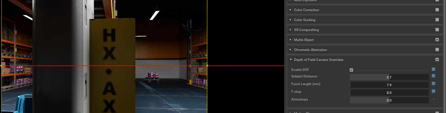

When I use depth of field override do I however get:
Which is also not how it should be. On the one hand now it is sharp but there is no depth of field.
I use
2023.1.1 (forced to at the moment)
but have also tried the same with 4.5 and the result was the same
Why is there this discrepancy between theory and simulation and also between the two ways of using the camera parameters?

The discrepancy between the two controls is because of different units.
The camera controls accept focal length in tenths of scene units, while the override controls work in mm.
Although the parameters are in the pinhole section (inside camera settings), they work for all projections

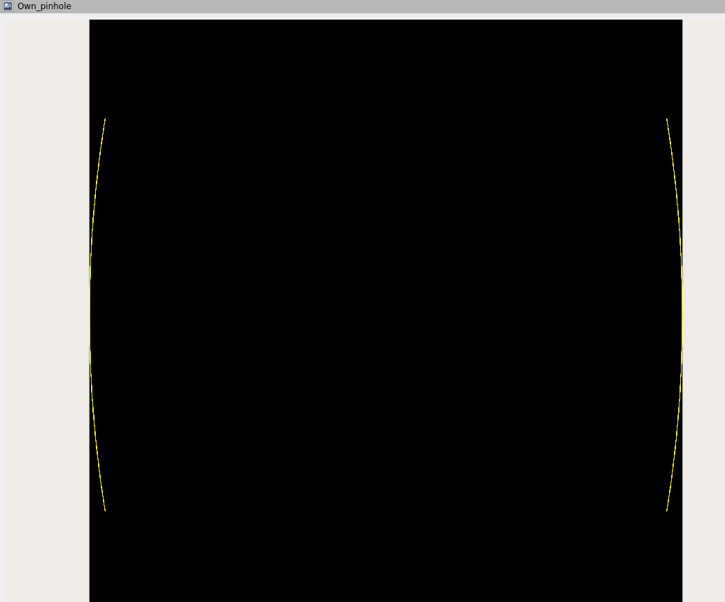

Maybe to also visualize that there seems to be something off with the projection types (use same focal length and aperture) would I expect that equidistant projection type would lead to a significantly higher FOV but it does not, see:
Using pinhole
Using equidistant
In both cases are the yellow bars at the same posiiton (just at the edge) and therefore the measured FOV is the same (roughly 71 degrees , which it should only be for the pinhole case:
Using the (inverse) formulas for the projection type would I expect it to be alsmost 82 degrees:

The recording of the issue regarding the field of fiew which does not change with changing projection type. Yellow bars are at 1m distance to camera and outwards just at edge to measure angle (FOV) .
Video showing that changing s parameter does not change FOV

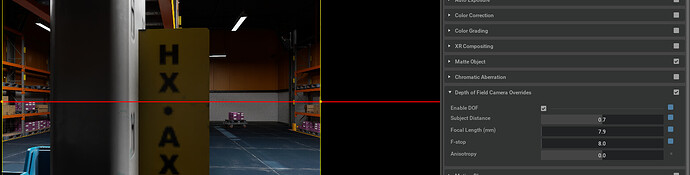

And for the issue with depth of field of the overrides and the different projection types
The yellow board is at distance 0.29m (which is below the 0.35m which should be the near limit for the depth of field and therefore be not so sharp) the post to the left of it even closer.
And here looking at boards at different distances to see that when setting the focus distance to that of the boards distance makes it sharp but the other ones in the distance not (they should be), here using pinhole and no override. Here I would expect all of them to be sharp with the 0.7m focus distance setting

For the second video: the parameter s only affects some fisheye projections. But you are in pinhole projection
For the third video: we do not support DoF in real time mode for those projections (fisheyeOrthographic, fisheyeEquidistant, etc). DoF support for non linear projections in RT was added only to fisheyePolynomial, and later on to several other models (the ones from OpenCV).
