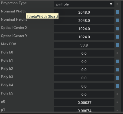

I have a question regarding the Focus Distance property of the camera. I have different real world cameras which I want to simulate as close as possible. I only have the datasheet, so no distortion values available. My question is how I should choose the Focus Distance value?
For example it I want to model this https://mvpaerospace.com/wp-content/uploads/2023/04/mvp_camera_datasheet_v2.pdf camera with this optics: Lensagon BMK2119C – Lensation GmbH?
I looked into the LeopardImaging β†’ Hawk-> LI-AR0234CS-GMSL2-OWL
camera which is already modeled in Isaa sim but could not figure out how to find the value to use for the Focus Distance
Furhtermore, to figure out which projection type to use: So far I used the stated resolution, pixel pitch and vertical/horizontal FOV from the datasheet and then calculated which of the fisheye models (projection types ) had the lowest error. Is there another way to better figure this out and then model the camera as close as possible?
Ont the Max FOV property, is it correct that this only plays a role for β€œtrue” fisheye cameras, so if my vertical/horizontal FOV is below 100Β° I can just set this value to a big number. Or how does it come into effect if I use e.g fisheyeEquidistant (with around 80Β° horizontal/vertical FOV)?

Regarding the OWL, yes I saw this documentation. I was wondering why the focus distance deviates and also for the cameras SG5_IMX490C_5300_GMSL2_H110SA and SG8_AR0820C_5300_GMSL2_H60SA (part of Isaac Assets) which have fisheye orthographic and equidistant projection type how to know why this is the correct projection type, such that I can also use the method to figure out my projection type for the cameras I use. Also how to get the focus distance parameter, since this and the projection type is not stated in their datasheet.
Thats why I proposed the method of calculating the error for the three different projection types, as with the pinhole ptojection type the image is only sharp at a narrrow band
I also looked at the existing SG8_AR0820C_5300_GMSL2_H30S1A , which uses the pinhole projection type, however there nothing is sharp ind the render.
Thanks for the feedback
Also when looking at the MaxFoV parameter, does the documentation show that this is the diagonal FoV Camera β€” Omniverse IsaacSim latest documentation, however when looking at any of the exisitng Sensing cameras (e.g the SG5-IMX490C-5300-GMSL2-Hxxx) is the value set to the bigger one of vertical or horizontal FoV.
How should this parameter now be used?

I wanted to ask for clarification regarding points of the camera:
  1. Angular field of view: Is it correct that the following formula determines the angular field of view if pinhole is used? (f = focal length, H = horizontal aperture)
  2. Can you confirm the following units
    focal length = mm
    Aperture = mm
    Focus distance = m
    Nominal width/height = px
  3. Which of the parameters under Fisheye Lens need to be set (accurately) if I use pinhole as a projection type?
I’m struggeling a lot with the focus distance. I have now done extensive research on depth of field but still struggle to find out which value I should put in for a specific camera for the focus distance. This β€œmoves” the sharp part (depth of field) forward and backwards.
An answer on how to figure this value out would be greatly appreciated, thanks.
