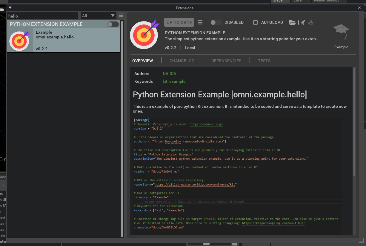

I see, yes you can write a custom extension. There is a hello world extension you can use as a template:
Extension docs:
https://docs.omniverse.nvidia.com/py/kit/docs/guide/extensions.html
You can also use the native python workflow to install your own pip packages and import other libraries.
So you can do any file decryption, write the file to a temporary location and then load the usd stage and continue.

Trying to open the extension window, but then isaac-sim container crashed. Found the same issue in forum:
Is this problem fixed? I’m using version 2021.1.0
Hi Seyoatda,
Please upgrade to 2021.1.1 this should be fixed there.
Kindly,
Liila
already upgrade to the 2021.1.1, the extension window works fine. Thanks for developers’ work
