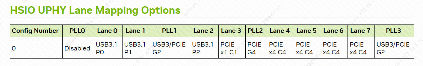

In this chapter, I don’t seem to see a example to enable PCIe endpoint mode on Orin NX.
https://docs.nvidia.com/jetson/archives/r35.3.1/DeveloperGuide/text/SD/Communications/PcieEndpointMode.html#pcie-endpoint-mode
Referring to the example of AGX Orin, can I change the UPHY0 configuration by setting hsio-uphy-config of the ODMDATA value to enable PCIe0 endpoint mode on Orin NX?
Table 7-3 in design guide seems to indicate that possibility:
Configuration options are not listed in the section “Jetson Module Adaptation and Bring-up”.
https://docs.nvidia.com/jetson/archives/r35.3.1/DeveloperGuide/text/HR/JetsonModuleAdaptationAndBringUp/JetsonOrinNxNanoSeries.html#configuring-the-uphy-lane
Did I miss some instructions? Can anyone clarify that?

The software support for Orin NX C4 ep mode is not fully completed. We notice several limitations.
Hi WayneWWW,
Thank you for clarifying that. Could I know in which release this feature is planned to be improved? Thanks!
B&R
The next rel-35.4.1 will have all the software ready.
Currently they are not present in the rel-35.3.1 BSP.
