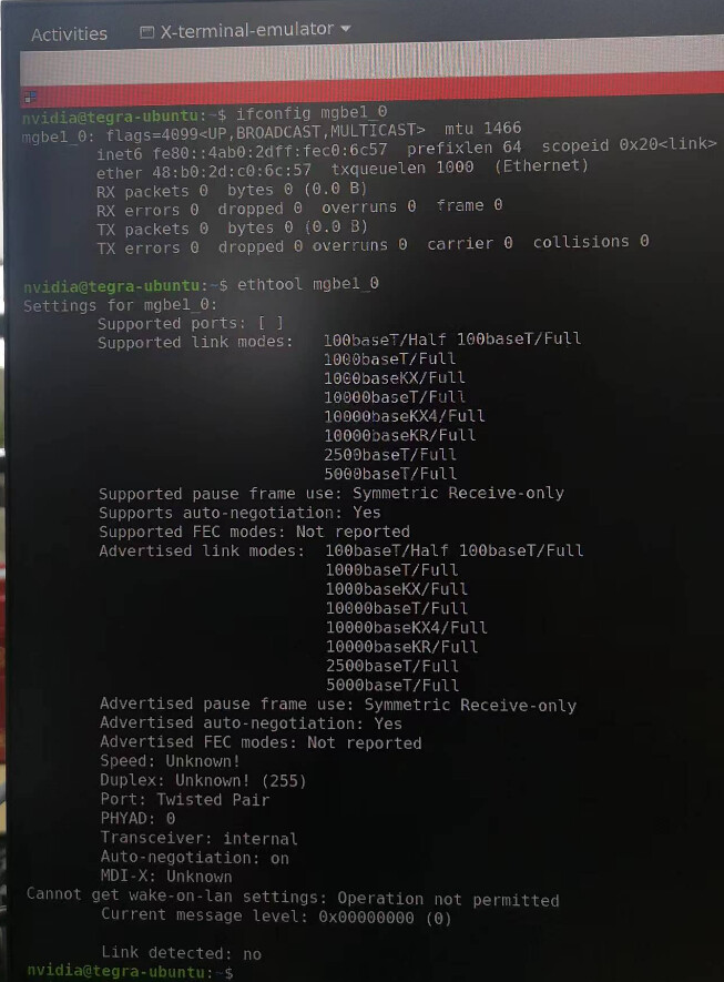

We tried to ping Devkit directly from another computer through a network cable, but got an error: “Network is unreachable.”.
Here is the ping command and the printed Logs
zc@Linux:~$ ping6 -I enp0s31f6 fe80::4ab0:2dff:fec2:6c57
ping6: Warning: source address might be selected on device other than: enp0s31f6
PING fe80::4ab0:2dff:fec2:6c57(fe80::4ab0:2dff:fec2:6c57) from :: enp0s31f6: 56 data bytes
ping6: sendmsg: Network is unreachable
^C
— fe80::4ab0:2dff:fec2:6c57 ping statistics —
8 packets transmitted, 0 received, 100% packet loss, time 7161ms
