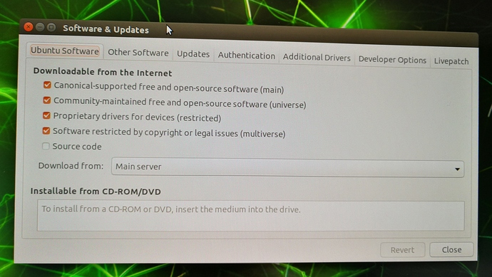

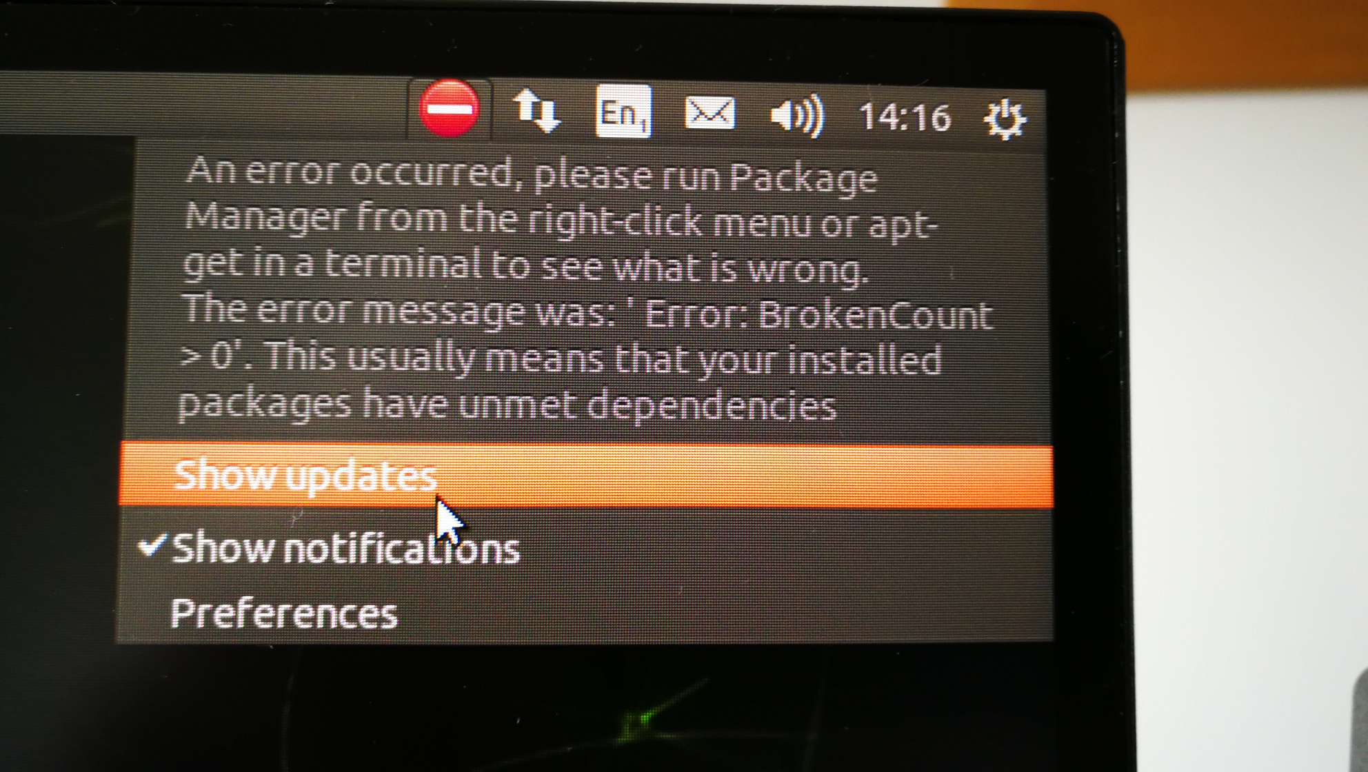

I checked the Jetson Nano, it seems that the image generated by flash command has something wrong which may result the install components failure? Please refer to the photos taken from the Jetson Nano screen:

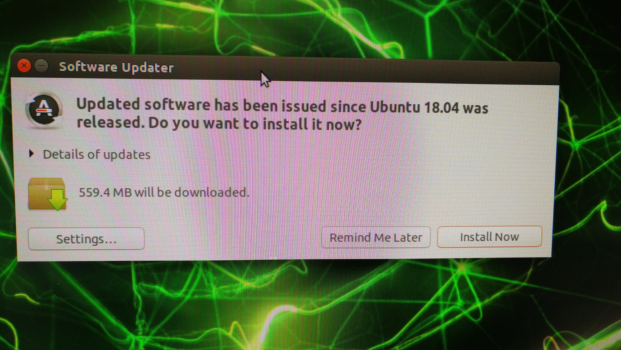

The software updater shows lots of installation needs to be updated (refer to photos):

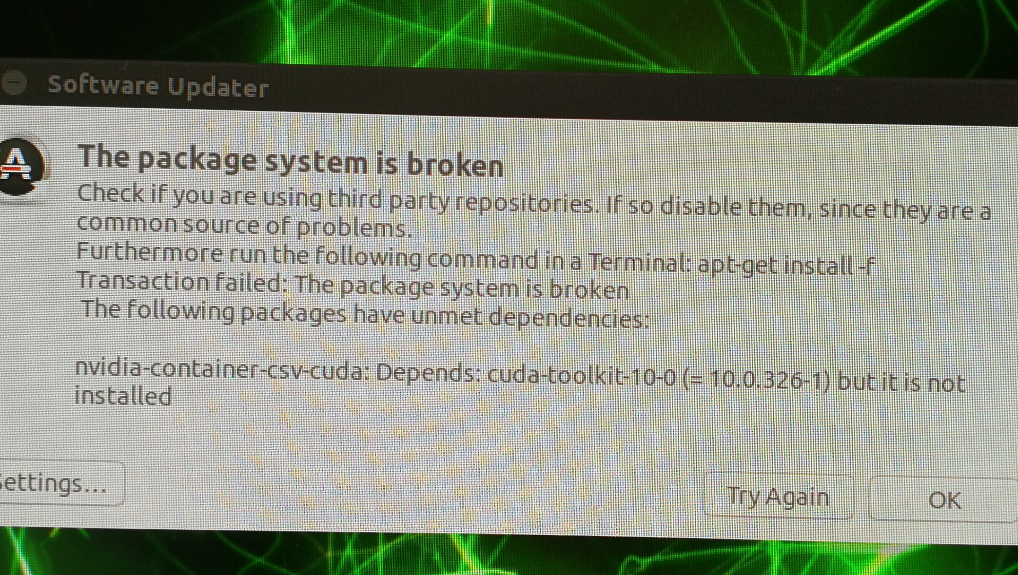

I tried to update them, but failed as below:
What can I do for it?
Hi changwen.xie,
The picture you posted here is normal behavior because the installation is broken.
Please try to use latest sdkmanager (jetpack4.4).
