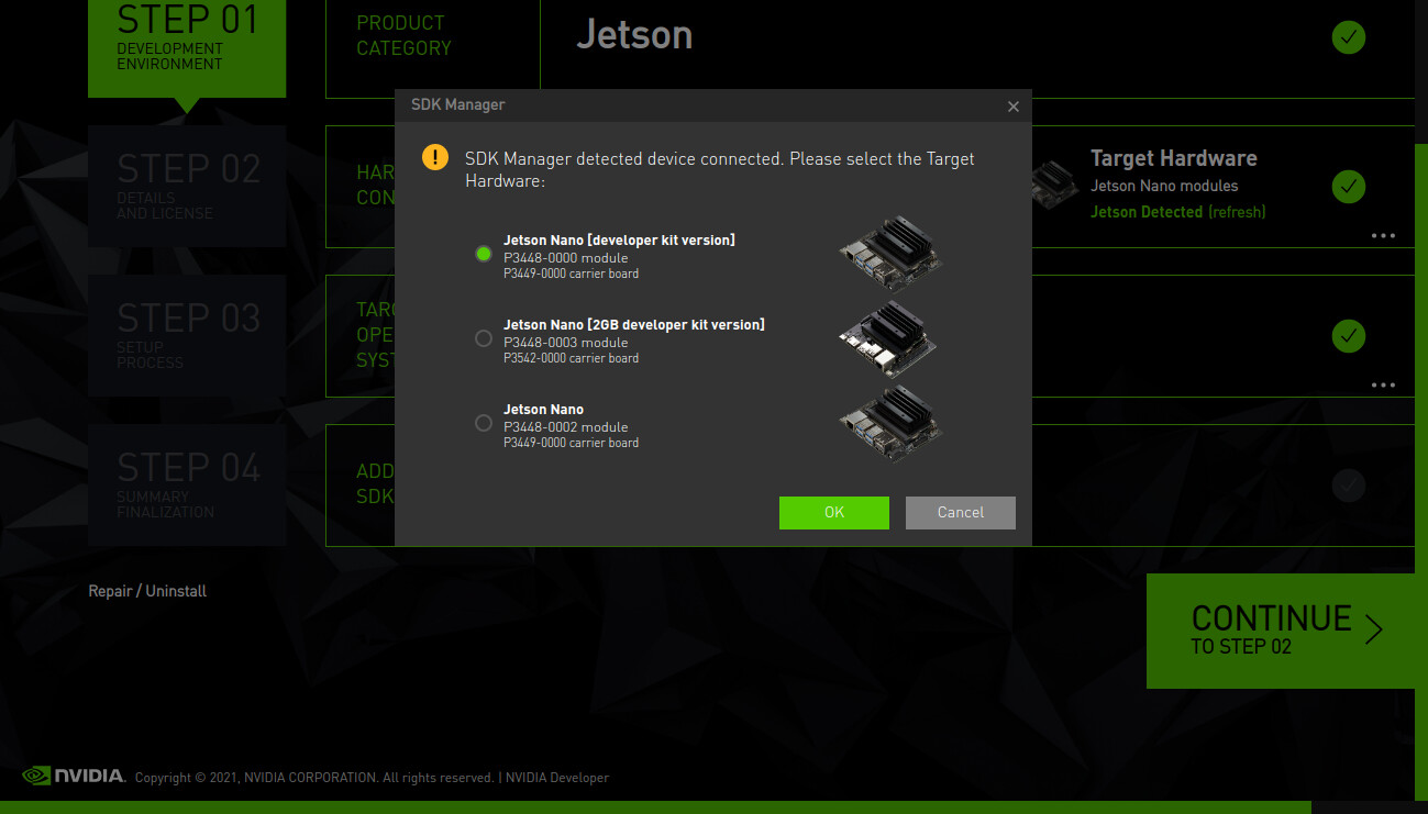

when i use SDKM which module should i choose
my model is P3450 , i think my jetson is B01
  1. If your board is 4gb jetson nano with sdcard slot and devkit, then what you chose is correct.
