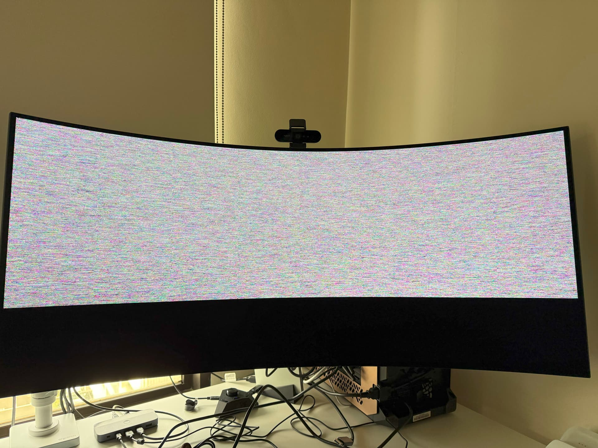

I have a 5090 and LG 45GX950A and it can’t run 5k2k at 165Hz on driver 580. Tested on Arch.
Could you be more specific? Does the option not show up? Are you using hdmi or display port? Have you tried both? Please include more details.
I tested this using hyprland and sway by manually setting the resolution and refresh rate in the configs. Before upgrading from a 4080 to a 5090 I had the error where it was out of mode and it would never show anything. Since going to the 5090 I can set the setting to 5120x2180@165 but that would result in corrupted output (photo attached)
There is no issue with DisplayPort however DP causes very poor resolution when POSTing and in UEFI mode.
