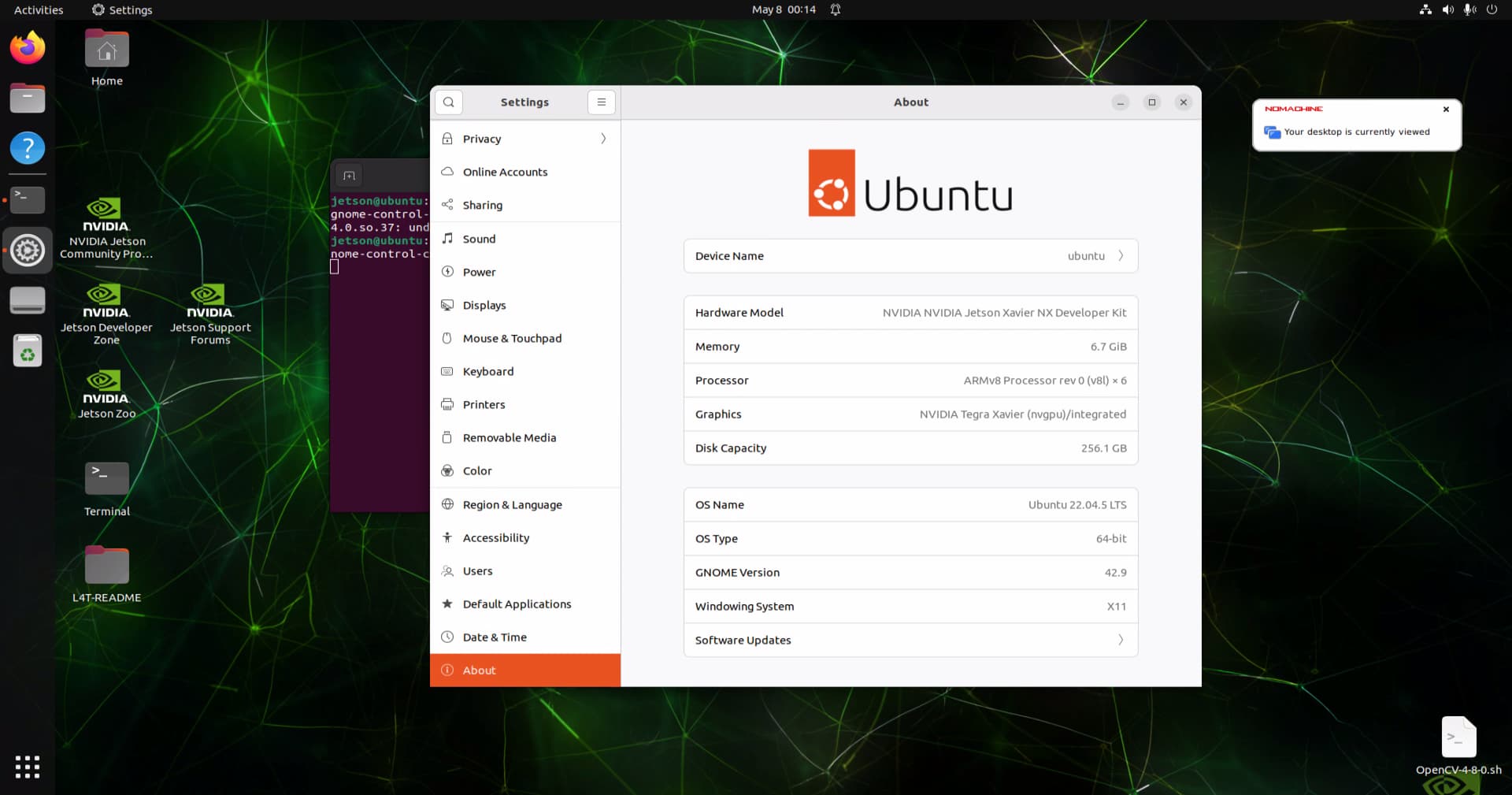

3. (Optional) Install Ubuntu Desktop (Partially Functional)
If you want to use the Ubuntu Desktop interface, you can install it here. Note that some GUI applications (such as Settings) currently may not work properly under Ubuntu 22.04. However, this does not affect the use of ROS 2 Humble.
sudo apt install ubuntu-desktop
Fix SSSD startup error
sudo cp /usr/lib/aarch64-linux-gnu/sssd/conf/sssd.conf /etc/sssd/
sudo chmod 600 /etc/sssd/sssd.conf
Enable GDM to launch the desktop environment:
sudo systemctl enable gdm
To ensure GDM starts automatically on boot, edit the service file:
sudo vim /usr/lib/systemd/system/gdm.service
Add the following at the end of the file:
[Install]
WantedBy=multi-user.target
Known issue: Settings app (gnome-control-center) won’t launch
This issue is caused by a Jetson-specific symbolic link:
libdrm.so.2 is linked to NVIDIA’s custom libdrm_nvdc.so, which is not ABI-compatible with the standard libdrm.so.2.4.0. As a result, graphical apps like the Settings panel fail to start.
As a workaround, you can preload the standard DRM library when launching GNOME settings:
LD_PRELOAD=/usr/lib/aarch64-linux-gnu/libdrm.so.2.4.0 gnome-control-center
This workaround allows the Settings app to open, but it’s not persistent. If anyone knows a more permanent solution, please share it.
