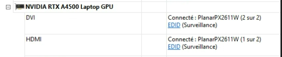

Both are connected to the Nvidia Card:
Both has the same resolution and parameters, and yes they are both external monitors:
As I said, the Stereo Clone mode is activated and works fine. We just need to flip one of screens so the mirroring glass show both image aligned and not one flipped! It’s a plannar setup.
As I said, the Stereo Clone mode is activated and works fine. We just need to flip one of screens!

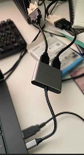

It’s WORKING, it has taken some time to figure all out, but now it’s working. It’s pretty simple in fact, just need the right configuration and adapters.
So our setup:
  • Dell Laptop Precision 7770
  • Plannar setup (2 screens with DVI connections with a mirror)
  • One USB-C to dual HDMI connector, connected to USB-C DP capable laptop port
  • Two HDMI to DVI adapters
  • configuremosaic utility updated as 2025-06
  • We have to re-enable the laptop screen in the Windows configuration
The command that works for us:
configuremosaic set passivestereo mirroring res=1920,1200,60 rows=1 cols=1 out=0,0,nm out=0,1,vm
Depending on the screen connection order, we sometimes have to change the vertical mirroring screen out=0,1,nm out=0,0,vm
A picture of the setup:
