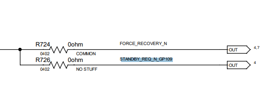

How to operate these two pins (SLEEP_REQ_N and MODULE_SLEEP_N) to enter SC7 – Deep Sleep State
I want to control these two pins by an external MCU… Make ORIN enter and leave Deep Sleep State
Is it possible to modify tegra234_wake_events to add gpio as wake-up pin ?

L11 is for Sleep Request. You can use the pin with “wake” function to wake up system. You can find the “wake” pins in pinmux sheet.
Can the Developer_Kit test be test ?
see P3737_A04_OrCAD_schematics.pdf
How does the SLEEP_REQ_N behavior control ORIN to go to sleep ??
In normal working mode, press FORCE_RECOVERY KEY to enter sleep ??
You should unmount R724 and mount R726 to test that.
