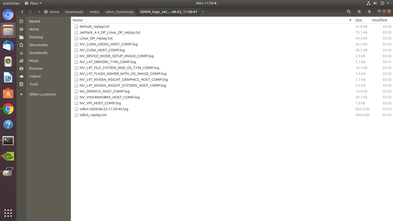

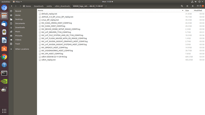

Export log from SDKManager has the following files. Which file is flash & uart logs?
I have uploaded all files.
default_replay.txt (31.1 KB) JetPack_4.4_DP_Linux_DP_replay.txt (68.5 KB) Linux_DP_replay.txt (48.1 KB) NV_CUDA_CROSS_HOST_COMP.log (25.9 KB) NV_CUDA_HOST_COMP.log (27.5 KB) NV_DEVICE_MODE_SETUP_IMAGE_COMP.log (2.3 KB) NV_L4T_DRIVERS_T194_COMP.log (5.6 KB) NV_L4T_FILE_SYSTEM_AND_OS_T194_COMP.log (10.1 KB) NV_L4T_FLASH_XAVIER_WITH_OS_IMAGE_COMP.log (1.4 KB) NV_L4T_NVIDIA_NSIGHT_GRAPHICS_HOST_COMP.log (2.6 KB) NV_L4T_NVIDIA_NSIGHT_SYSTEMS_HOST_COMP.log (2.9 KB) NV_OPENCV_HOST_COMP.log (14.5 KB) NV_VISIONWORKS_HOST_COMP.log (38.8 KB) NV_VPI_HOST_COMP.log (7.7 KB) sdkm-2020-06-22-11-29-44.log (668.3 KB) sdkm_replay.txt (395.5 KB)
