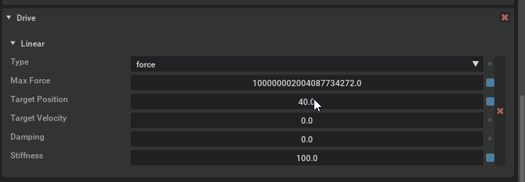

Hello, according to what you said, I would like to know how to set stiffness and damping in the PrismaticJoint to meet the hydraulic drive effect I want
In Omniverse, you can look at the Prismatic joint demo to play with this.
Window->Simulation->Demo Scenes->Joints->Prismatic Joint
Go down to Drive panel in Property View:
Here, Target Position is where your hydraulics are trying to drive the piston.
Higher Stiffness will push harder but will also create higher frequency oscillation, like a stiff spring.
If your system is pressure limited you can drop down the Max Force.
To counteract the oscillation you can then raise the Damping. I don’t have any real life experience with hydraulics but my guess is that this should be sufficient.
Your suggestions are very helpful to me, but I do not know what mathematical formulas they meet when setting damping, stiffness, target position and target speed so as to better simulate the lifting process of hydraulic support. In the future, I want to add joint force sensor to obtain the force provided by it. At present, although the visual effect can be simulated, it is not known whether it is accurate, and the process of hydraulic support lifting should be slow, but this obviously cannot control his speed.
I see. All I can add is that the drive model we use is very simple, the formula is this:
force = springCoeff * (targetPosition - position) + dampingCoeff * (targetVelocity - velocity)
With the force being clamped to not exceed Max Force.
You can write e.g. a PID controller on top of this to continuously adjust the parameters to get a certain desired macro behavior.
The coefficients also get normalized by the simulation time step so that the formula is simulation frequency invariant.
