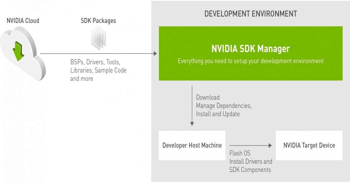

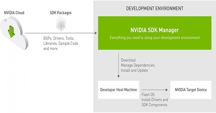

Hi @darinhodson
Sdk manager can be another option for you.
