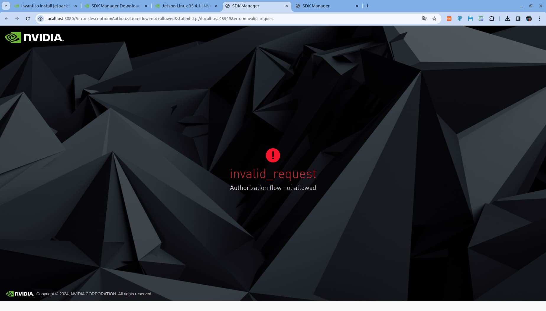

thank you. However, if you install and run sdkmanager 1.8.4, there is a problem where you cannot log in. Is there a solution?
