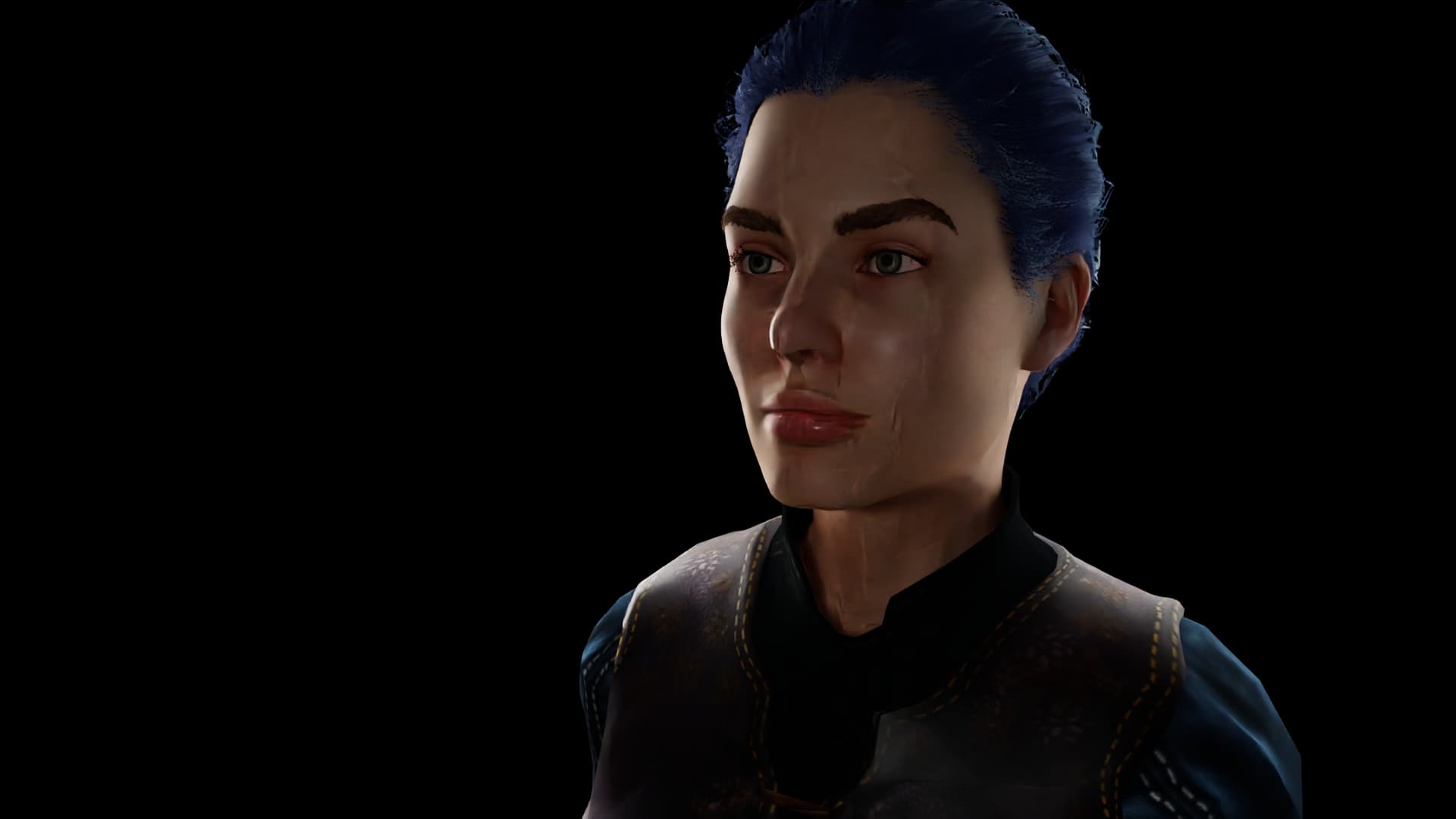

Then how about the hairlights I have made with dome+texture and a large rect light behind her, see they look so good on Path Traced:
Why is that light missing totally on Iray? Otherwise the Iray looks great!!

The latest Create & CC connector is still having problems with Iray photoreal on hair key light.
Path traced:
Iray:
Which version of Create are you using? It looks to me that the hair is black in Iray, so I assume there is some issue with the hair material, or even parts of the hair geometry that is missing.
Even with latest Create 2016.3.6.
the same problem exists:
With Path Traced it looks ok:
I guess it is the fact that Omniverse CC connector does not support iray.

Hi Pekka, after speaking with the devs it sounds like this scene is probably applying a hair shader on triangle data instead of hair geometry (curves). This is not really correct and for that reason not supported by Iray, though we might consider adding some kind of support for this similar to what RTX Path-Traced does. If this is the case the hair would render completely black, which seems consistent with your images.
It would help a lot if you could provide the USD scene. Then we can verify that this is indeed the issue and would also help us judge if we could do something for this specific case.

This scene actually worked fine for me, so guess it doesn’t use a hair shader that requires curves in Iray. But I don’t understand why it doesn’t work for you… I also tried with 2021.3.6.
Same here now it works!
