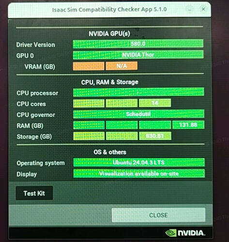

I installed Isaac Sim and run it. It report error continuously as it running.
2026-01-22T09:59:12Z [195,105ms] [Error] [rtx.denoising.plugin] Failed to compile compute shader: rtx/nrd/PackForNRD.cs.hlsl
2026-01-22T09:59:12Z [195,137ms] [Error] [rtx.denoising.plugin] Failed to compile compute shader: rtx/nrd/PackForNRD.cs.hlsl
2026-01-22T09:59:12Z [195,166ms] [Error] [rtx.denoising.plugin] Failed to compile compute shader: rtx/nrd/PackForNRD.cs.hlsl
2026-01-22T09:59:12Z [195,197ms] [Error] [rtx.denoising.plugin] Failed to compile compute shader: rtx/nrd/PackForNRD.cs.hlsl
install process:
Check env: ./isaac-sim.compatibility_check.sh
mkdir ~/isaac
sudo unzip isaac-sim-standalone-5.1.0-linux-aarch64.zip -d ~/isaac
cd ~/isaac
./post_install.sh
And then the software could be started.
Steps to Reproduce
  1. run Isaac Sim with command: ./isaac-sim.sh
  2. the error info rise continuously.

NVIDIA DGX Spark is the only officially supported aarch64 platform for running Isaac Sim at this time. Jetson-based platforms, including Thor AGX, are not supported. The T5000 GPU embedded in Thor AGX may also lack parts of the RTX feature set required by the NRD-based denoising plugin, which is likely why the rtx/nrd/PackForNRD.cs.hlsl compute shader fails to compile.​
