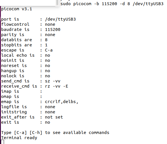

I tried implementing the Debug Console from another PC. The 4 USB Interfaces are being recognized. But i do not get messages over these interfaces.
I tried two tools: minicom and gtkterm
I was also debugging all 4 interfaces. None of them got any data.

  1. Is this AGX Xavier devkit or custom board?
  2. Are you able to see any log from the UART serial console as below setup with picocom instead of minicom?
    NVIDIA Xavier - Serial Console
Another question: For the serial console, which USB connector do you use (I am assuming a dev kit)? Is it the micro-OTG connector with the NVIDIA-supplied micro-B USB cable?
Hi WayneWWW,
  1. I am using the AGX Xavier Devkit.
  2. I do not get any output from picocom either
I checked if the USBs are available: ls -al /dev/ttyUSB*
The Output is:
crw-rw---- 1 root dialout 188, 0 Sep 13 14:14 /dev/ttyUSB0
crw-rw---- 1 root dialout 188, 1 Sep 13 14:14 /dev/ttyUSB1
crw-rw---- 1 root dialout 188, 2 Sep 13 14:14 /dev/ttyUSB2
crw-rw---- 1 root dialout 188, 3 Sep 13 14:17 /dev/ttyUSB3
I am using the dev kit and for debugging the micro-B USB connector with a micro-B to USB-A cable.
After you plug the cable and open picocom, please press the reset or power button and reboot the device.
Please do not wait for the device (maybe) already boot hang and then open picocom.
I am sorry, i do not get a signal either.

Bus 001 Device 005: ID 0403:6011 Future Technology Devices International, Ltd FT4232H Quad HS USB-UART/FIFO IC
This is not the device we want to see… So even “nvidia” is not showing in the lsusb now?
What you just told me is not correct?
werthmannlu75012
Yeah, it still says that nvidia is connected.
i am sorry for the confusion. I thought that this was the device we are looking for.
“nvidia” is not showing in lsusb. The only device that is showing up after plugging in the DevKit and entering the force recovery mode is the one mentioned above.
Just to confirm that … do you know what is the correct connection here?
This “Future Technology Devices International, Ltd FT4232H Quad HS USB-UART/FIFO IC” device is showing up on your host because you connect the micro usb port on jetson. And this is only for dumping the log. This does not have functionality to flash board…
To flash board, you need to connect the flash port (type C), put your board into recovery mode and check the lsusb again…
I would suggest you can read the developer kit user guide to make sure you understand the function of each port.
Only one type C port on the device has the function to flash. The other one cannot.
