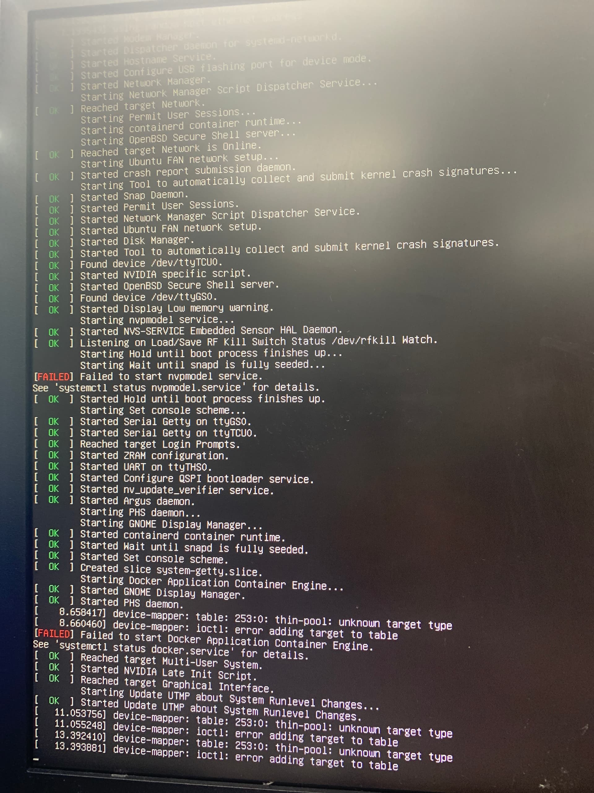

When i switch on AGX Xavier developer kit, i am facing the follwing error in the screen, after which i am not able see the login console.
[Failed]: Failed to start nvp modelservice
Kindly suggest the fix.

  1. I am using jetpack 4.6 rev2 which got populated automatically during sdkmanager installation.
  2. When i tried to switch to console, the screen is not stable. It is continuously blinking. But i managed to enter the credentials and got the screenshot of nvpmodel service and gdm3 service. Kindly find the attached image.
It looks like the installation from sdkmanager has something corrupted.
The log says your nvpmodel binary does not exist. Could you check the rootfs on your host machine and see if this exists in sdkmanager folder?

Yes, then please flash your board again. Maybe previous flash has something wrong.
Thanks! I have tried it couple of times, i didn’t succeed. Got stuck in the same page.
Can you check if this file really does not exist on your jetson xavier?

I didn’t find it xavier(nvpmodel).
Ok, could you reply below questions?
  1. What did you do after each flash with sdkamanger? Did you configure your user account each time over the HDMI monitor? Is it always failed with nvpmodel? or something else would fail too?
  2. Could you copy and paste the boot log from this uart serial console and attach the full log?

  1. Each time my user account credentials was validated. It always failed with nvpmodel. No other models got failed.
  2. Before attaching the boot log from uart serial console, i jst removed the manually and reinstalled nvidia-l4t-3d core. The console(GUI) started appearing. Though nvpmodel error is still there, now i am able to see the login screen.
    Attached is the screenshot.
Hi Hitesh,
My console screen with GUI started coming. There was some broken packages. I have manually removed and re-installed it again. But still nvpmodel error is there. I will use some other jetpack or reflash it.
Thanks for your support. Attached is the screen shot.
