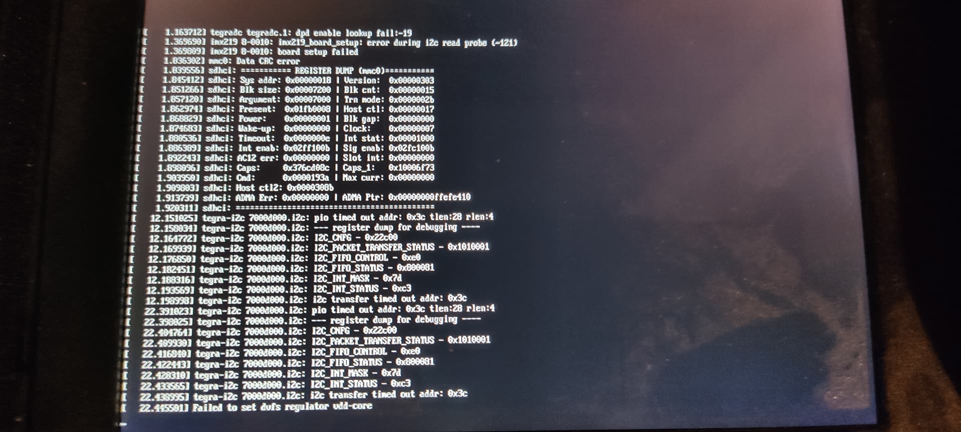

Jetson Nano will not boot. Need help identifying (possibly hardware) fault
My Jetson DevKit started to behave erratically and today stopped to boot completely, I suspect it is a hardware issue. Here are some screenshots of a boot process. I’d be glad for any help to find a possible issue.
Thanks in advance.

[   31.870990] mmc0: Data CRC error
It seems there’s error from your SD card.
Could you change another SD card and flash it again?
