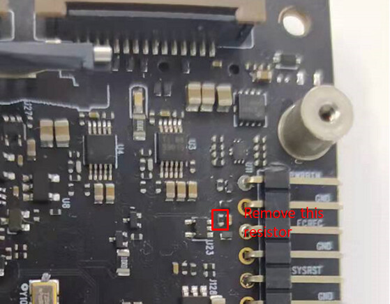

We have purchased a number of A206 carrier boards for the Nvidia NX line, Xavier & TX2, and have seen an endemic booting problem across a wide number of these boards. On average about 50% will boot like normal, but the other 50% aren’t even initializing the processor (USB devices don’t seem to get power either).
Another issue relates to the reliability of the booting carrier boards when temperature changes occur. They aren’t booting with the ambient temperature getting anywhere near the 80°C quoted temperature rating overall. After coming back down to a lower temperature, each board seems to “like” a different temperature and will start booting again. The Nvidia development carrier board always booted in equivalent testing scenarios.

Does anyone have ideas about test points in the 260 SO-DIMM connector in relation to Xavier NX/TX2 NX processor initialization?

Carrier board in question:
If NX / TX2 core board is used in A206, a pull-down resistor shall be removed in A206.
This fix is the solution to our booting issues. We have been unable to get the boards to fail after this. Temperature sensitivity has greatly improved as well. Any issues mentioned in this post have been solved.
