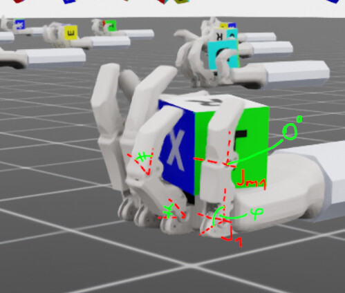

Mimic Joints are taken over into the USD file but not as a rigid linkage with no give and appear rather to be linked by what i assume to be a tendon or a spring since they tend to oscillate or give in if pressure is applied (see Fig.1.).
Fig. 1
the pinky finger is extended to its max while it is supposed to look more like the ring finger where the mimic joints has the same angle as the parent joint. The urdf that is also available in the git repo works without a problem on itself.

hi @re23m017, thanks for posting your question, also thanks for sharing all the resources to debug the issue. It is unexpected that mimic joint requires a high stiffness to work. I will look into this soon and get back to you.
Hi @re23m017, sorry for the very long delay to get back to you. For clarification, it seems from this that you are already setting some joint stiffnesses to 1e9.
You mentioned that
Do you mean that you had to re-set the mimic joints to 1e9?
Hello, my first approach was to set the stiffness in code when importing the URDF and automatically saving as USD, which didn’t work. What did work for my model is when I opened the URDF in IsaacSim, using the “URDF Import Wizard (Beta)” and then manually set the stiffness and dampening through the UI. The model could then be saved by manually exporting it as an USD. This then worked. Both approaches use an unchanged URDF to then modify and save as USD before counting the work with the USD.
I see what the problem is. So to clarify, modifying Drive parameters (stiffness damping) through the GUI works. But when you load the asset through Isaac Lab ArticulationCfg the stiffness/damping parameters are not set. Is that correct? I am seeing this behavior on my side as well if that is the case.
Yes, exactly! Sorry if my original explanation was a bit too complex. I really appreciate your simplified summary, it gets straight to the point. Is this issue with how I am handling the urdf at import or somthing with the ArticulationCfg?
There is a known issue in IsaacLab where Joint stiffnesses set via ArticulationCfg actuators don’t appear in Isaac Sim’s USD Properties window. The reason is the under the hood, this parameter setting uses ArticulationView:set_dof_stiffnesses() which is the low level PhysX interface. So it skips the USD layer and this data does not get propagated back up to Isaac Sim USD.
That said, the stiffness does get written correctly to the physics engine so the dynamics behavior should be correct to what is set via ArticulationCfg actuators. It is confusing that the GUI will show the stiffnesses as not updated.
Best way to solve this mismatching GUI parameters is to set the parameters directly on the USD and save the file, but besides the GUI there should not be differences in the physics dynamics. We are working on getting a fix for this in the next releases of Isaac Lab.
Thank you for the clarification! I initially thought the stiffness wasn’t taking effect in the sim at all, but knowing it’s applied at the PhysX level helps a lot. The issue must then lie somewhere else in my code. I’ll look into it now with this in mind. Appreciate the help!
