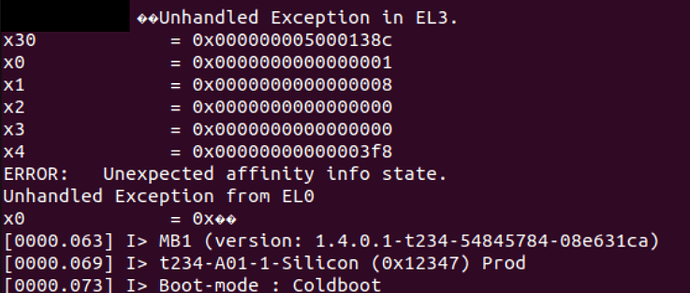

An update on my end:
The SOM booted up normally today and was on for about 5 minutes. After the 5 minutes, it failed with the following error:
When it rebooted, it came up with the same SDRAM initialization error.
Not sure if that’s board or module issue, you ,may try to get other device to test.
