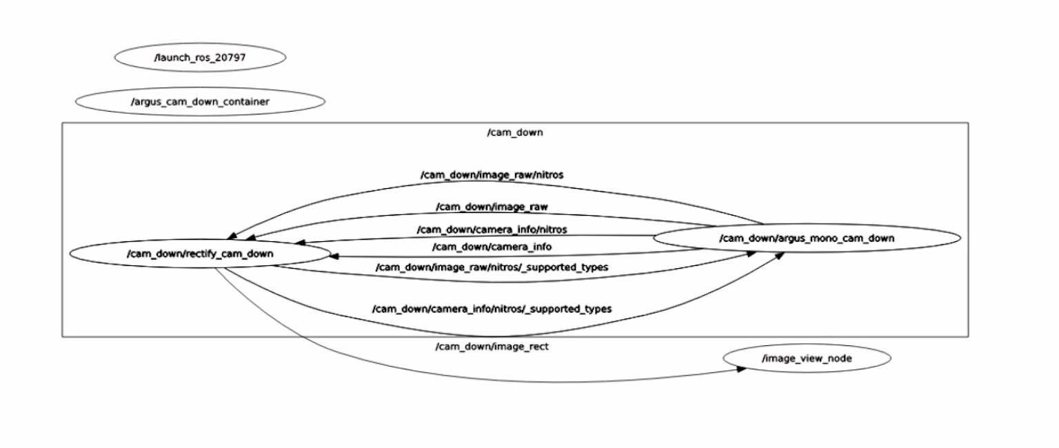

I am also experiencing this issue with a single pipeline, and it appears to work randomly (but sporadically). The system is not under any other load. The image_raw topics are publishing fine from argus_camera.
With no changes at all to code, configuraitons or file paths, I either I get:
a) a perfectly rectified stream at high fps
b) an empty image
c) a completely warped image (like I described earlier was occuring with x2 simultaneous pipelines)
To your points:
  1. The camera_info_url is set up and loading the correct config. When echoing the camera_info topic, it reflects this data correctly.
  2. rqt_graph attached. Looks OK to me maybe I am missing something.
Please find attached (filenames are altered for attachment):
