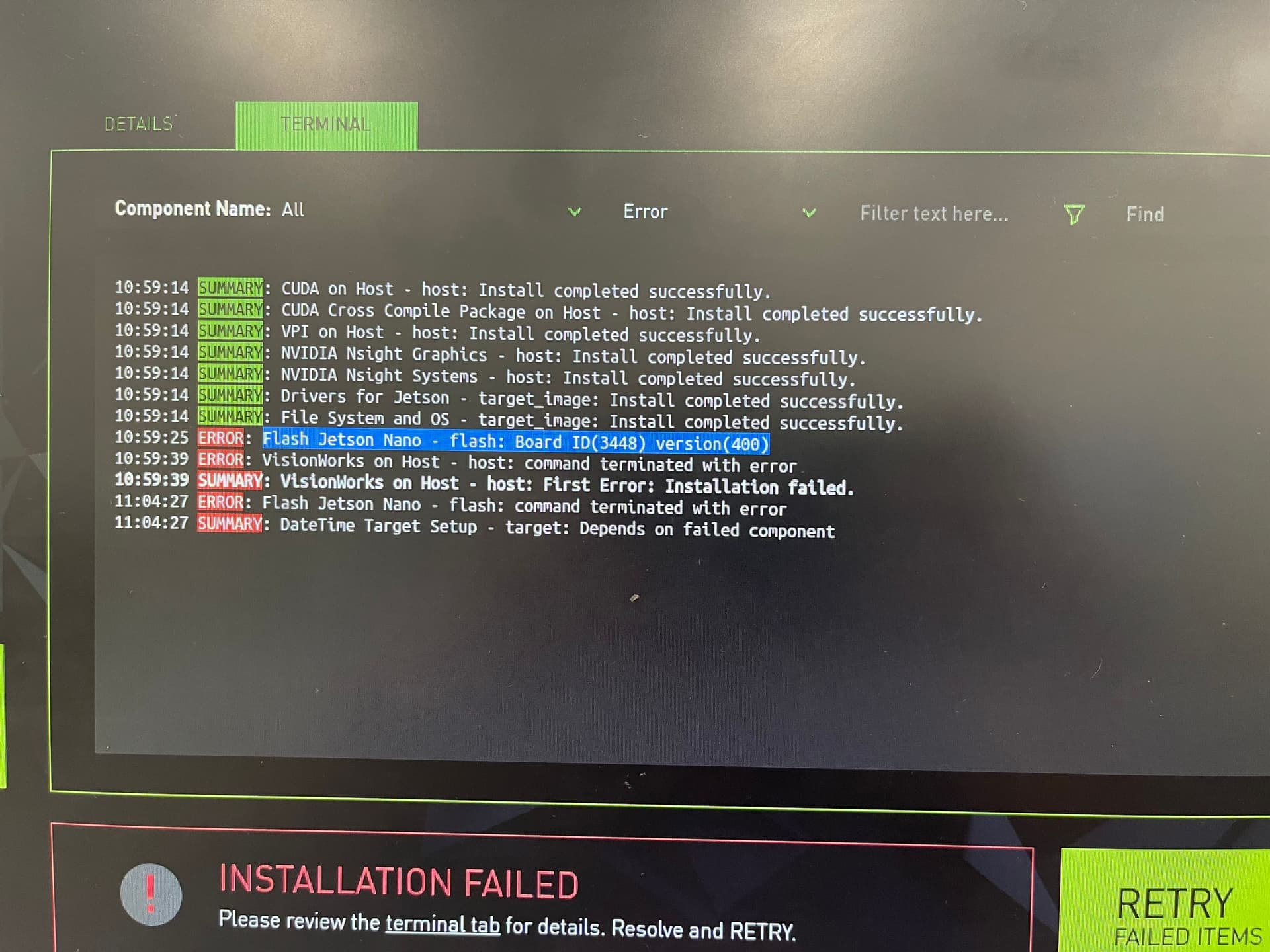

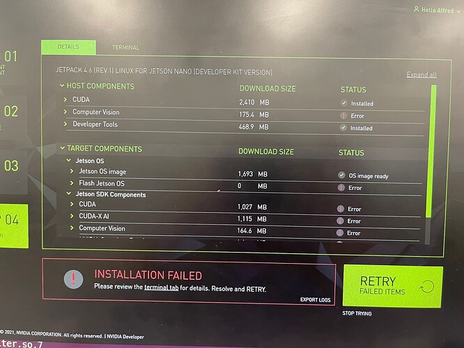

Nano can't be flashed by sdk manager 1. 6.0.817
I have tried for several times. Here is the error

Hi AlfredNG,
In the flashing log of Nano device, there is following error:
ERROR xmllint not found! To install - please run: “sudo apt-get install libxml2-utils”
Can you please run above command to install libxml2-utils then retry flashing?
For the TX2 flashing error, I’ve directed to other colleague for more investigation.
hello AlfredNG,
there’s an error about Reading board information failed.
could you please put your target to enter forced-recovery mode and use lsusb to check the device-id.
thanks
nano or tx2nx?
Creat! Nano is OK!
