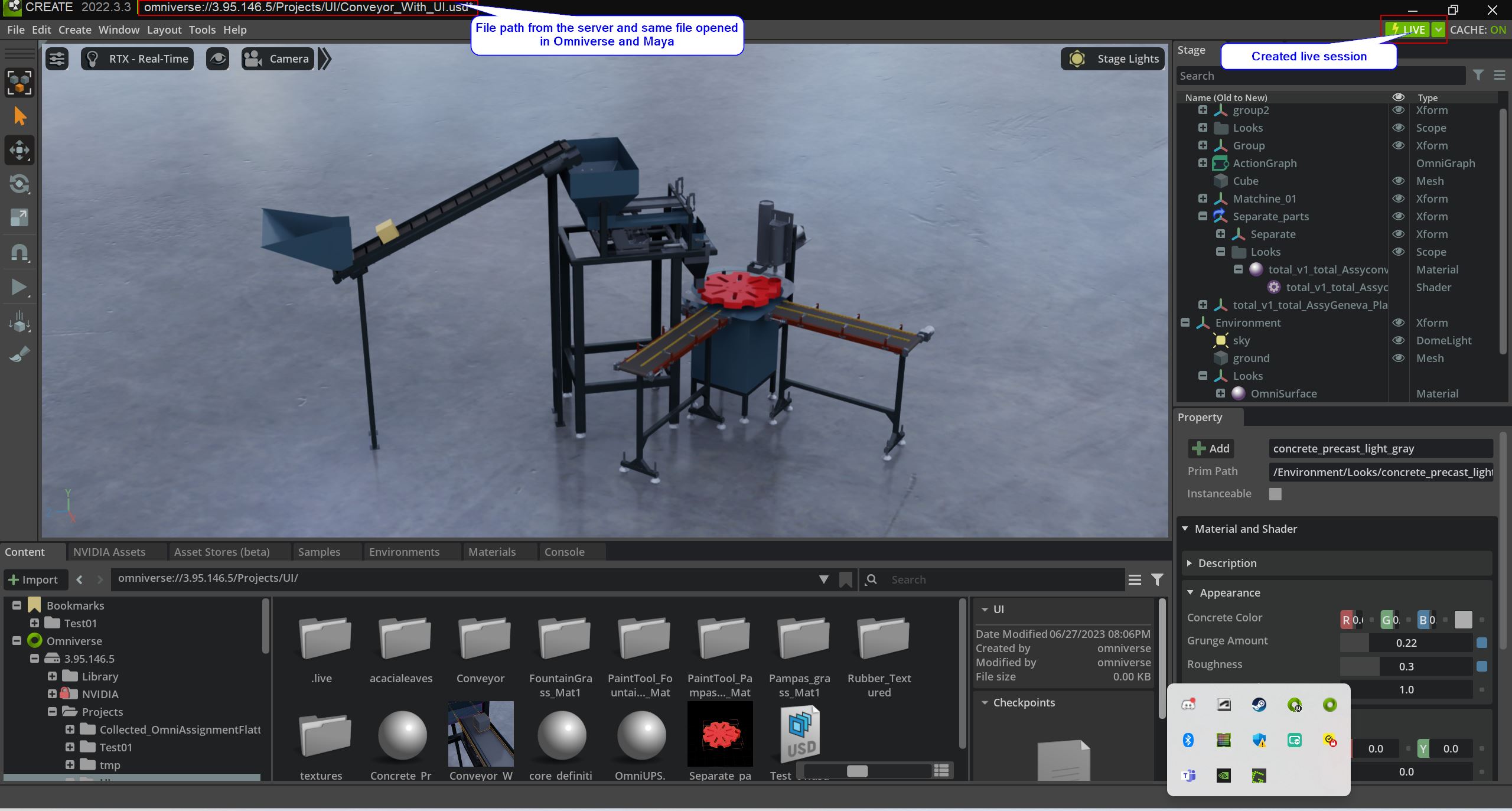

I have faced problem with “Live” button in Legacy connector in Maya, that is not getting live on the file I opened from the server in Maya and Omniverse to concurrent work.
But “Live” button activates when I open another file from the same server. Not sure what is the issue.
Steps I followed:
  1. Started the cloud Nucleus server.
  2. Started live session in OV and singed in to same server in Maya.
  3. Opened the same file in Maya and OV
    However Live button from OV shelf is disable and not live.
Maya version. 2023
Omniverse Create(USD Composer) version 2022.3.3
Maya Legacy Connector 200.4.0
Does anyone faced similar issue.
