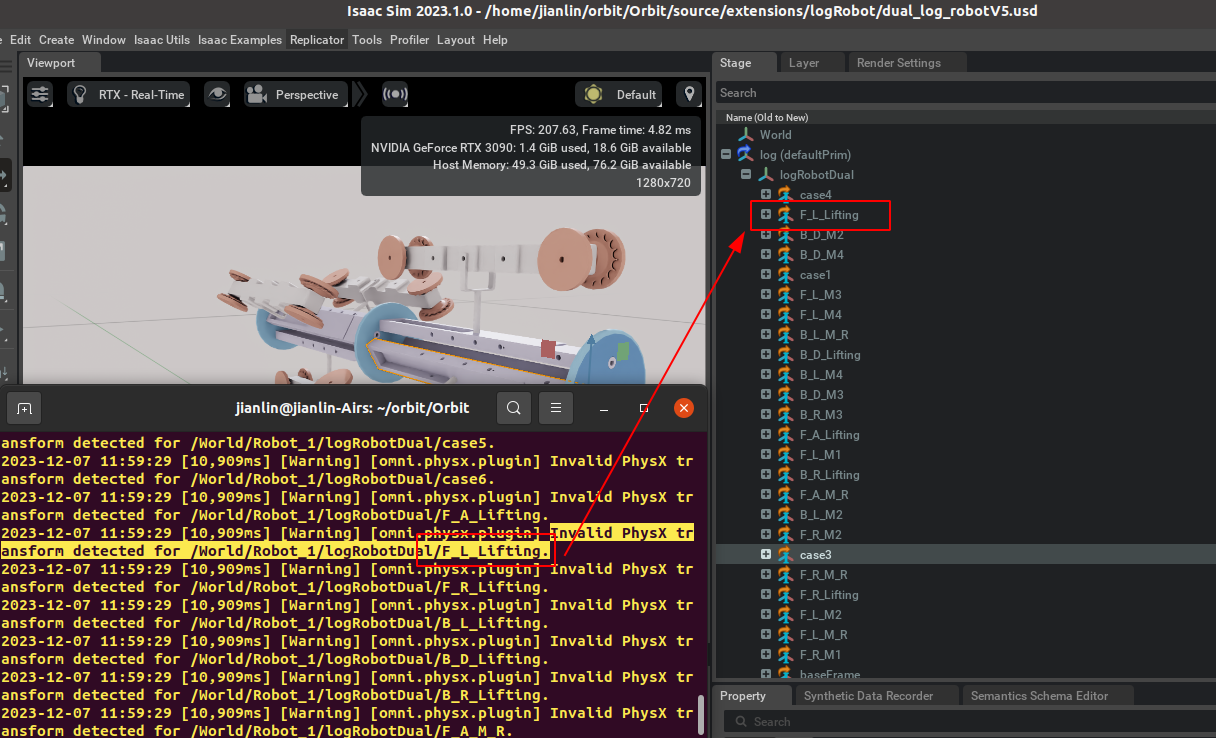

Hi, I am trying to run a self-designed robot with Orbit Framewok, and I keep having the following questions:
And as shown in the figure, it says, Invalid PhysX transform detected for “/World/Robot_1/logRobotDual/F_L_Lifting”, which is every coordinate in the USD, as shown in the following figure:
I have no idea which part is wrong, and many thanks for any advice and help!
Many thanks for any suggestions, and happy for any discussion!
this usually means that the simulation is not stable and the rigid bodies endup with NaN in transformation.
You can try to simulate on CPU to see if CPU handles the simulation better (Window->Simulation->Debug - override the simulation between CPU/GPU). You can also try different solvers TGS/PGS.
You can also try to increase the simulation frequency on PhysicsScene prim.
If all fails, feel free to share the asset if you can we can try to take a look what the problem might be and suggest solution.

Looking at the provided asset there are some differences with the importer. In the latest importer it also imports tendons, those actually do break the simulation. They were missing in previous version. Not sure if the import settings changed, but thats the difference.
