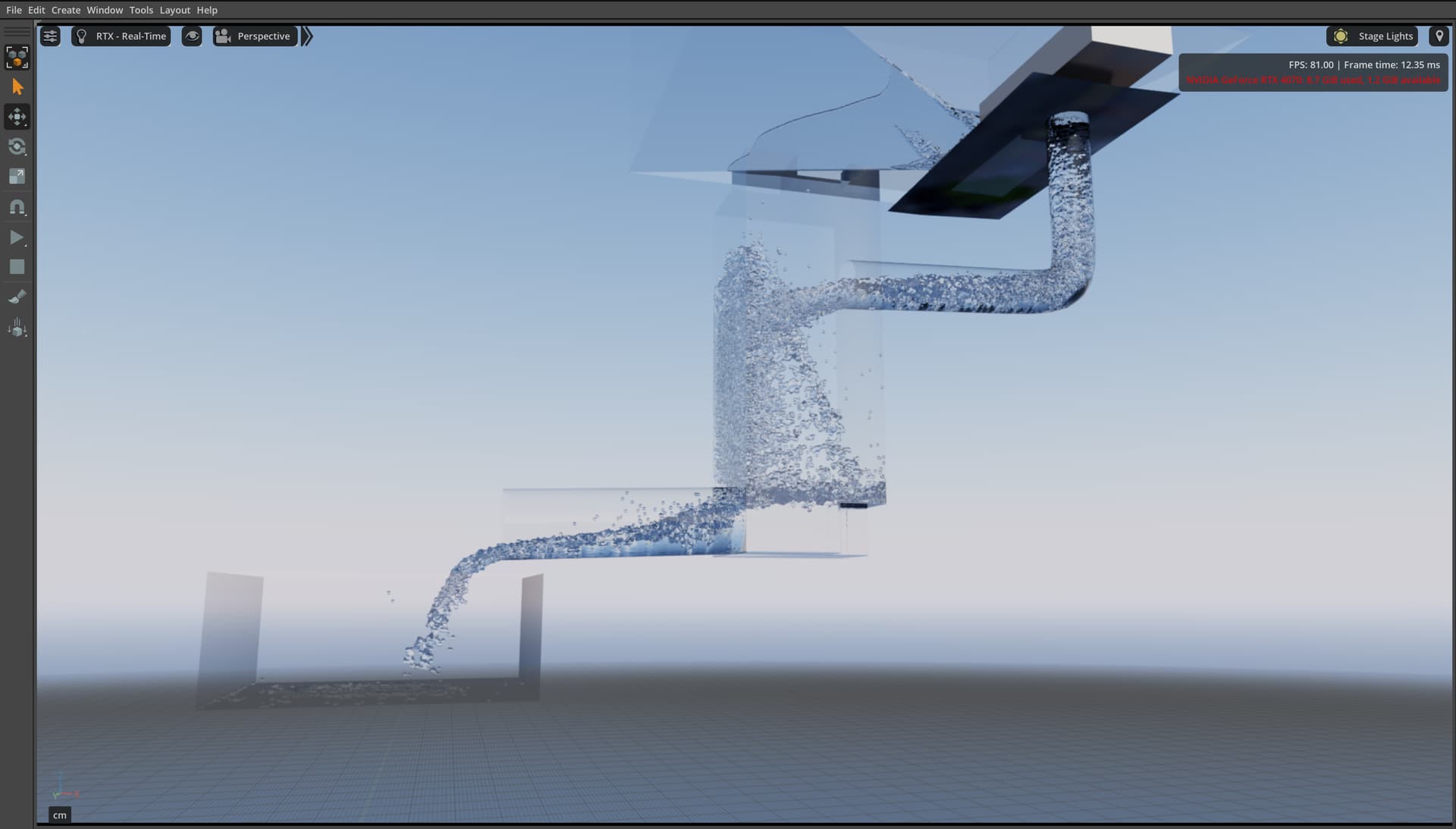

I’m looking to create a water simulation where Physx particles are continuously emitted and destroyed, creating an endless water flowing animation.
I looked up the “Paint Ball Emitter” demo in the Physics Demo Scenes and replicated the emitter function using Action Graph script node.
Now I’m at the destroy particle part and I don’t know where to start.
I’d like to create a prim that can delete any colliding Physx particles. So I can imagine there are probably two scripts to write.
-A collision event that triggers the destroy function, along with the identifier for the colliding particles
-And the script that destroys the particle in question
Looking at script used for emitting particles, spawning a particle seems to be as simple as adding an extra element to an array, so I suppose deleting a particle would be of similar concept, but I wouldn’t know how to find the index of a specific particle.
The emitter script based on the sample script is in enabled “single particle set” and disabled “use instancer” configuration so as to contain all the particles within one prim.
Any insight would be appreciated. Many Thanks.

Since we don’t support contact reports for particles, you will have to implement the intersection logic in your script to identify the particle indices that you want to remove. Then I think you should be able to just do a replace with last operation on the UsdGeom.Points point array attributes. I think that should work but I haven’t tried it myself.

A very crude script written to sequentially check if each point of the particle is below a certain Z-value, and by popping the particle elements out of the array, I managed to destroy the particle.
But this detection and popping operation has slowed down performance for quite a significant amount.
I also looked into the PhysX overlap nodes in the Action Graph, specifically “Overlap, Prim, All”, but apparently this and other similar nodes can only detect prims with collider components, it can’t detect Physx particles, nor can it output which indices of the particle is in collision with the input prim.
Is there another method of calculating particle intersection? Is there a function to determine whether a coordinate/point is within a geometry?
Yes this is expected. You are running now two complex physics commands and it will be cpu bound. Normally people would run the first particle emitter and not worry about destroying them at the other end. Is this for a specific use case? Some kind of effect you need rendering? What is the final output for this?

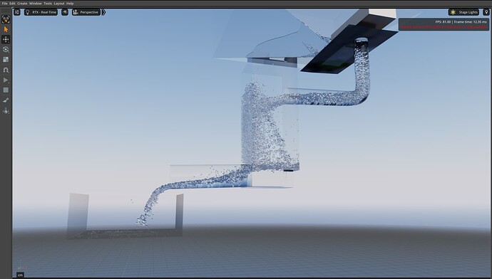

I’m creating a simulation of water running through a funnel.
The simulation would be running for a long time, which means Omniverse would be calculating particles running through the funnel, as well as the particles on top either waiting to flow through or waiting at the bottom. So I’m looking for methods to improve the framerate by creating particles at run time (which I can also control its spawn rate and initial velocity) and deleting particles that has passed through the funnel.

Run using 2.4GHz 24-Core Intel Xeon Silver 4214R and RTX4070. With the exception of stuttering when creating and destroying particles, the simulation would run at 20-30fps. Destroying particles, depending on the amount of particles deleted, can freeze the simulation for up to 20 seconds.
I was wondering if the checking/appending/popping can be optimized, perhaps using warp in script node can speed things up while keeping use of the PhysX particle system. Otherwise, destroying the particles using script node would be too resource demanding and I’ll choose to limit the simulation time.

I don’t have a good recipe for you for really good performance. We don’t have draining nor overlap, nor contact report support for particles unfortunately. We also don’t support Fabric at the moment, which would have been a good option together with warp code on the GPU as you mention.
I can only suggest some workaround which might be good enough:
I suggest you use Gf.Range3d.IsInside(…) to check overlaps. To make this a bit faster, you don’t have to do the intersection test every simulation update. You can just test a small portion of all active particles per simulation update, and always consider another small set per update. I don’t think you need to be very exact when it comes to particle removal. For particle counting something similar might work too, but it’s a bit more tricky.
Once again by writing a crude Warp script to check and mark the number of particles passing through a set X-axis position at each set time interval I managed to calculate the flow rate. While I couldn’t find a function called IsInside() in the Gf.Range3d class (at least on pxr-usd-api Gf docs anyway), I did see an other function called Contains(), which I believe would serve similar purpose. I’ll try to get it running to see if it runs smoother than warp, or with warp function.
Particle removal at this point becomes too resource intensive to be kept as a feature, and so I’ll limit the simulation time to about 30 seconds.
