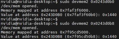

I use the following command to refresh the generated cfg file to TX2
sudo ./flash.sh jetson-tx2 mmcblk0p1
Then, use the following command to view the value in the register:
sudo devmem2 0x0243d0b0
However, the results obtained are inconsistent with the values in cfg
11
what you really want to check?
this is I2C7_CLK instead of audio pins you’re mentioned in comment #4.
please check TX2 TRM for [8.31.7 PADCTL Audio Registers].
Yes, this is a problem I accidentally saw after configuring the audio, so please ask.
Theoretically, shouldn’t the register values I see be consistent with those in the cfg file.
hello Yolomei,
cfg file is the init settings, it’s able to alter by kernel controls.

hello Yolomei,
that’s correct. you must perform full flash to update the cfg file
