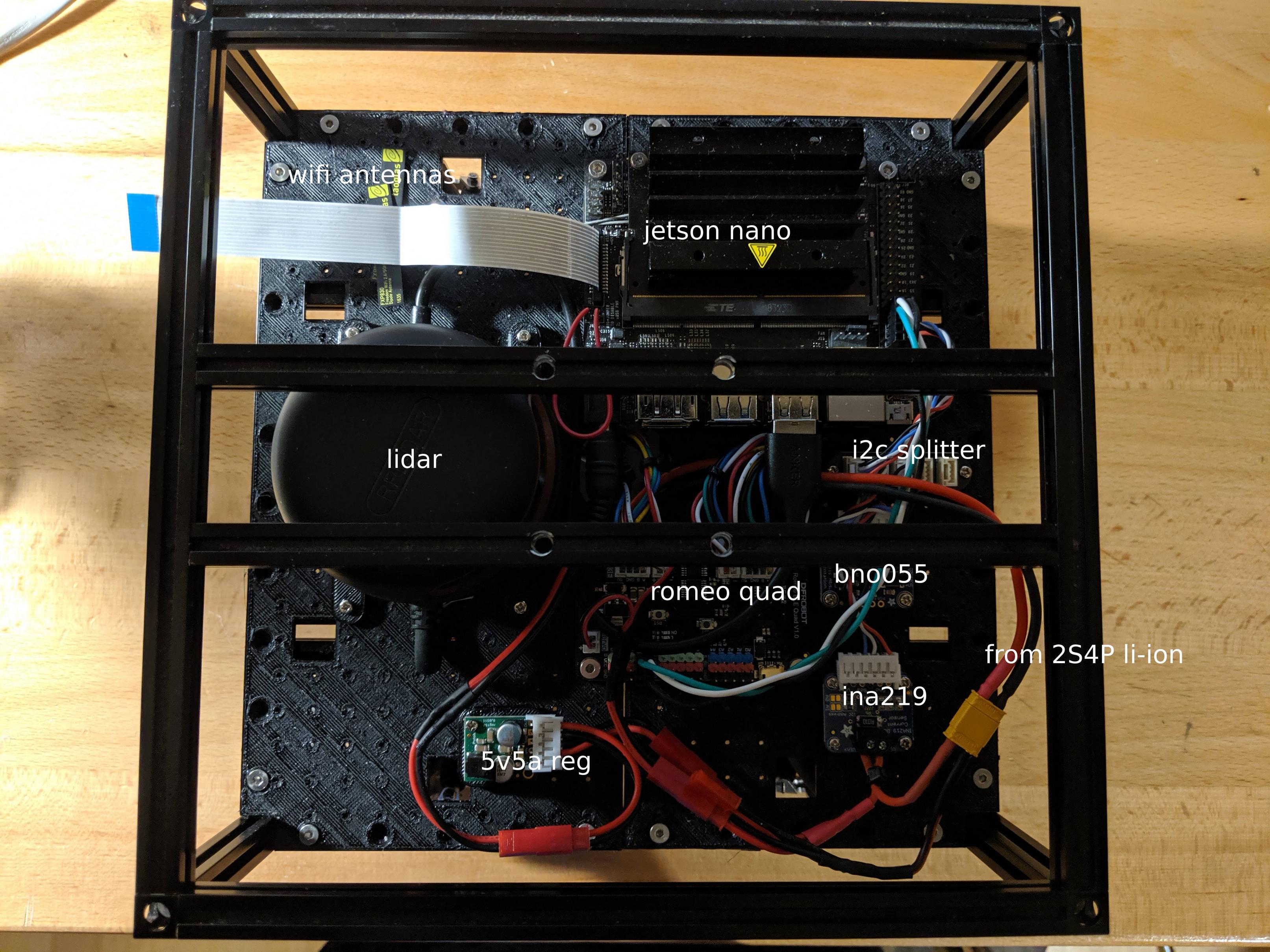

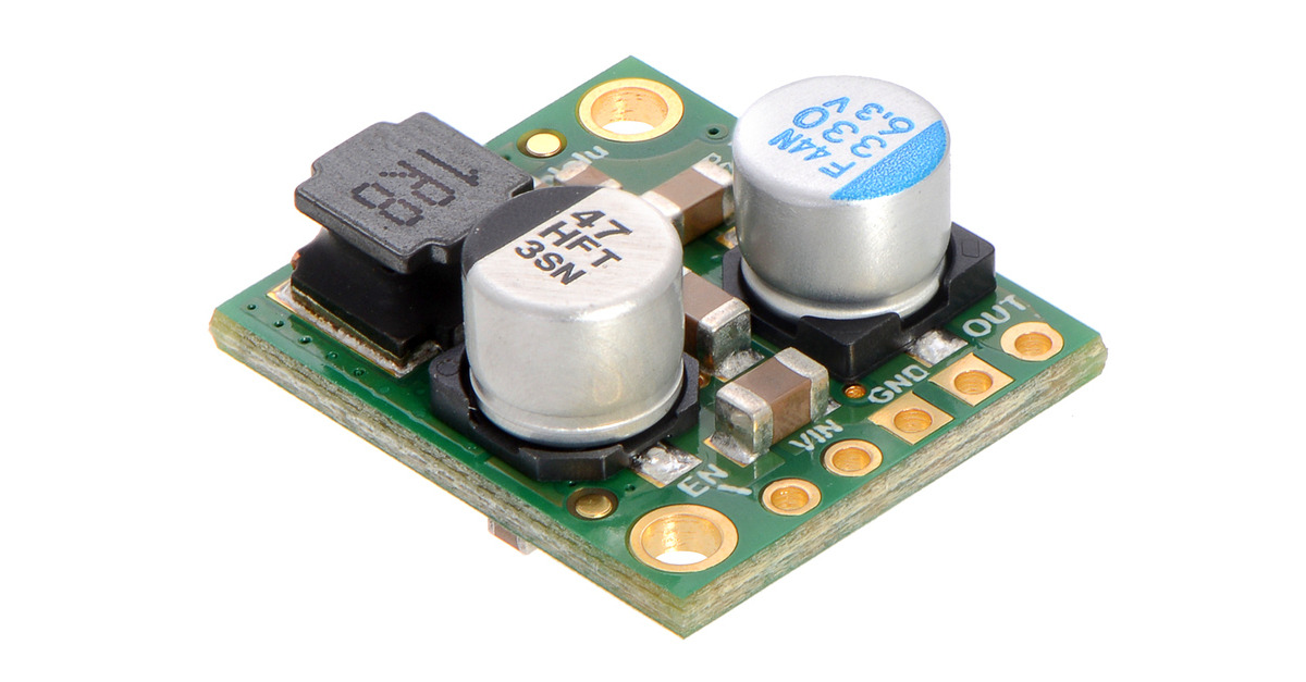

I’m running the Nano with a Lipo 2S and a Pololu 5V5A buck regulator. You probably want to get something that can handle at least 4A, preferably more.

@wuxiekeji Thanks for the links. If possible please show us a picture of your full setup too (i.e LIPO battery polou regulator barrel jack … nano).

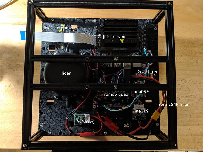

Here’s my setup. It’s a robot so there’s more stuff in there than you need to get going obviously.
Power from Li-Ion comes at the “from 2S4P Li-Ion” wire. The Li-Ion battery is on the bottom of the robot so you can’t see it from above.
There’s an INA219 current monitor right after the Li-Ion. You can skip that. Then I split into 3 JST-RCY connectors to power various other things. You can skip that too. There is also a JST-RCY mated connector after the 5V5A you can skip. You can go straight from 5V5A regulator to barrel connector.

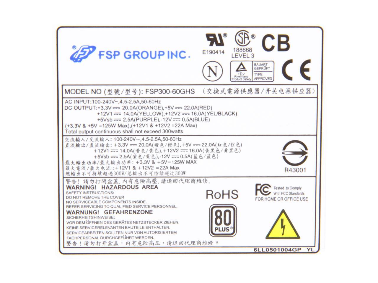

Wouldn’t it be ok to use a power supply that is rated for a higher amperage than 4a as long as the output is 5v? Computer PSU’s have 5v that typically is ~20a. https://c1.neweggimages.com/NeweggImage/ProductImageCompressAll1280/17-104-075-20.jpg
I would think this would be ok…?
You can probably do that but it is overkill – you just made your “Nano” 50X bigger. Also you need to jumper two ATX pins to have it turn on.
I would seriously test the Computer PSU by putting a 2.5 Ohm, 10 Watt load resistor on the 5 Volt output and measure the voltage. That is a 2 amp load.
Most Computer PSU’s have poor regulation at light loads. And the 5 Volt output is not the primary output so I would think that it has even poorer regulation.
You can make a 2.5 Ohm Load by connecting 2, 5.0 Ohm, 5 Watt resistors in parallel.
Good Luck!
