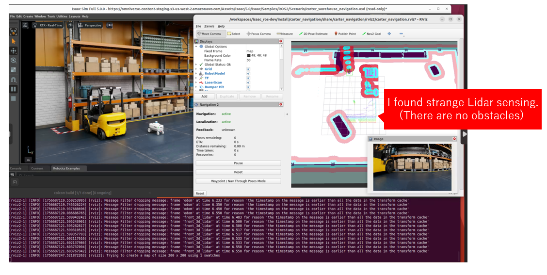

I try to run “ROS2 Navigation” based on below link guide.
https://docs.isaacsim.omniverse.nvidia.com/5.0.0/ros2_tutorials/tutorial_ros2_navigation.html
But Lidar sensing data seems to be strange like below.
I would appreciate if you check the behavior with Isaac-sim-5.0-full and tell us how to solve this problem.

@mat-h I tried it and don’t observe the strange lidar sensing as shown in your screenshot.
Based on your screenshot, I suspect that the robot is mislocalized, you can use Rviz “2D Pose Estimate” to relocalize the robot.
You can also try to enable “Show Debug View” in the ROS2Rtx Lidar Helper Node and see what is going on.

But we’ve still found strange behavior like below.
We can add “debug view” from your guide.
We need to change “Rotate-x=90” of PandaXT_32_10hz for proper debug view.
We found strange Lidar sensing view in Rviz2.
I didn’t need to do this. For enable debug view, did you stop the simulation, enable debug view and then restart the simulation?
Also have you tried to download the source code of Isaac Sim from github and then build it from scratch (I don’t think it would be different from the download link but worth a shot).

I followed the steps exactly from the tutorial ROS2 Navigation — Isaac Sim Documentation
The difference between yours and mine is that I didn’t run the carter_navigation in a docker container. I didn’t use isaac_ros_common. I just downloaded the IsaacSim-ros_workspaces . I have ROS2 humble installed locally. So I just build the package and source and launch it.

Unfortunately, I found same issue with ”ROS2 humble installed locally” from your guide.
It seems to be problem in Isaas-sim-5.0.
Best regards,
I’m just another user.
I tried it, with Isaac Sim 5.0.0 full (local installation) on Ubuntu 24.04, with ROS2 humble from Docker but without Isaac ROS, and did find anything unusual. Both at the original location and when I had the robot navigate closer to the forklift. If I have a chance I’ll try with Isaac ROS too.

@mat-h The stable version of 5.1.0 has been released. Could you please check if your issue exists with the latest version? Thanks!
mat-h
October 27, 2025, 4:04am
14
Thank you very much for your kindness.
I really appreciate your help.
I found proper behavior with IsaacSim5.1.0.
