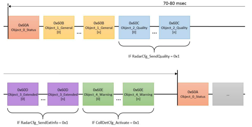

Here are some questions:
The radar that I’ve been used works like the below graph.
The whole scan needs several can messages to get all the data of detected objects.
The can message with can id 0x60A will tell how many objects is detected.
The following can messages will tell the other information of the detected objects.
Does it tell that the number of packets used to assemble a scan is not a constant?

numReturns : 0
_dwSensorPlugin_returnRawData
ContinentalARS408::returnRawData()
_dwSensorRadarPlugin_getDecoderConstants
_dwSensorPlugin_readRawData
ContinentalARS408::readRawData()
msg.id:60b msg.size:8
data: 355ad414801fc19d
_dwSensorRadarPlugin_validatePacket
ContinentalARS408::validatePacket()
rawData:
_dwSensorPlugin_pushData
ContinentalARS408::pushData()
_dwSensorRadarPlugin_parseDataBuffer
ContinentalARS408::parseData()
numReturns : 0
data: 425b53fd801fe188
rawData:
numReturns : 0
msg.id:60c msg.size:7
data: e8ca53a220e8
rawData:
numReturns : 0
data: 3484a33a180e8
rawData:
numReturns : 0
data: 178ca53a8220cc
rawData:
numReturns : 0
data: fa56d8c82208c
rawData:
numReturns : 0
data: 2c8ce53a8220cc
rawData:
numReturns : 0
data: 08ce53a220e8
rawData:
numReturns : 0
data: 358ca33a220e8
rawData:
numReturns : 0
data: 428ce53a8220cc
rawData:
numReturns : 0
msg.id:60d msg.size:8
data: e7d6fa0708055
rawData:
numReturns : 1
data: 347dfa06f8010
rawData:
numReturns : 2
data: 177d2fa0708055
rawData:
numReturns : 3
data: f7d8fa0708055
rawData:
numReturns : 4
data: 2c7cefa0708055
rawData:
numReturns : 5
data: 07d2fa0708055
rawData:
numReturns : 6
data: 357cafa17080ac
rawData:
numReturns : 7
data: 427bafa17080ac
rawData:
numReturns : 8
msg.id:60e msg.size:4
data: e000
rawData:
numReturns : 8
data: 34000
rawData:
numReturns : 8
data: 17000
rawData:
numReturns : 8
data: f000
rawData:
numReturns : 8
data: 2c000
rawData:
numReturns : 8
data: 0000
rawData:
numReturns : 8
data: 35000
rawData:
numReturns : 8
data: 42000
rawData:
numReturns : 8
