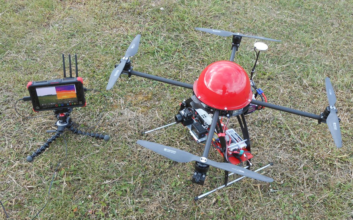

I have 2 Jetson Nanos with different cameras. Everything works fine and the latency is low. One is mounted on a copter.
Attached are a few pictures.
