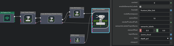

However, following error is occurred when start simulation and SDGPipline is not generated.
2022-12-26 02:32:10 [Error] [omni.isaac.core_nodes.impl.extension] Could not process writer attach request (True, <omni.replicator.core.scripts.writers.NodeWriter object at 0x7f5bacf17650>, ‘/Render/RenderProduct_omni_kit_widget_viewport_ViewportTexture_2’), Tried to create a node in a path without a graph - ‘/Render/PostProcess/SDGPipeline/RenderProduct_omni_kit_widget_viewport_ViewportTexture_2_NodeWriterWriter’
I run into the same issue. I realized that it is related to the pipeline that CameraHelpers creates to publish images. The pipeline is created and saved. A workaround to get the scene back to work is to save it as a USDA, open it with a text editor, find the line containing the string “SDGPipeline”. It will look something like this:
over “Render” (
hide_in_stage_window = true
over “PostProcess”
over “SDGPipeline”
over “RenderProduct_omni_kit_widget_viewport_ViewportTexture_1_NodeWriterWriter”
custom token inputs:encoding (
allowedTokens = [“rgb8”, “rgba8”, “32FC1”, “32SC1”]
Then, if you remove everything inside the “Render” and save it, the scene works again.
