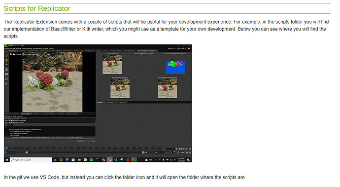

I am trying to find the Scripts for Replicator folder, because I want to take a look at the implemenation of the Basic Writer, but I am not able to find it. In the documentation there is a gif, that should show where this folder is located. Unfortunately it does not show the location of the folder. Maybe someone knows where I can find it and maybe correct the documentation as it is very confusing.
Hi @julian.grimm thanks for pointing this out. I agree this isnt clear and I’ll make a ticket to get this addressed.
In the interim open the extensions tab, under the menu Window>Extensions. In the Extensions tab, search for Repliactor, and select “Omni Replicator”. CLick on the folder or VS Code icons highlighted in green in the image below. Inside omni\replicator\core\scripts is the folder being referred to.
