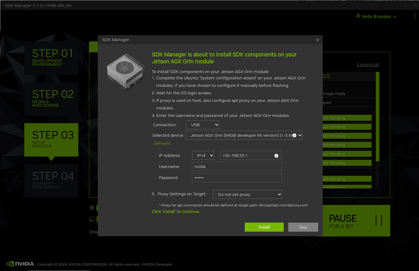

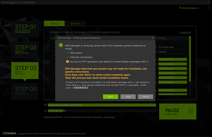

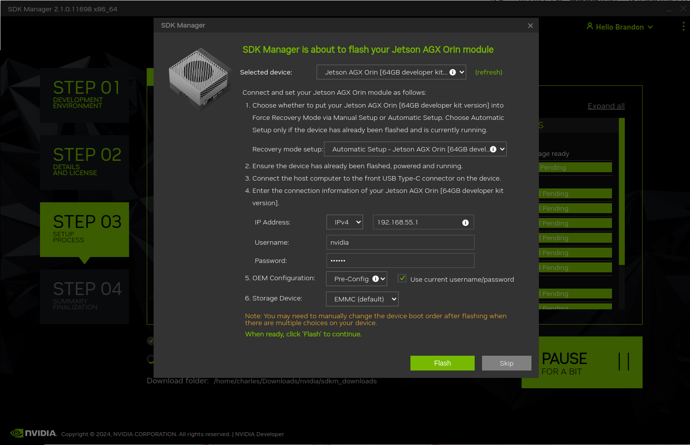

I followed the guide of SDK manager, using usb-network to connect orin device, but the installation failed. Here’re some screenshots and sdk logs, I’m sure I wrote the correct username and password of orin device, but both flash and APT test seems to get wrong password.

21:30:32 INFO: Gstreamer - target: [target] nvidia@192.168.56.1's password:
21:30:33 INFO: Gstreamer - target: [target] [sudo] password for nvidia:
Could you check why it shows 192.168.56.1 in the log rather than 192.168.55.1 from your screenshot?
Is the issue specific to USB-network?
Have you also tried to connect ethernet cable and install from there?
Hi Kevin,
I’m using jetson agx orin devkit. As for the ip address in log.txt, I did changed the usb ip address to 192.168.56.1 to debug the network, but I have tried setting 192.168.55.1too, still failed. As for ethernet connection, l used wifi on my orin device rather than wired network, is that the problem which I couldn’t ping APT ?
Could you try to run ping google.com from your device to check if it could access the internet now?
