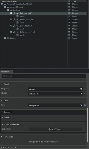

I am attaching a SolidWorks example model here which includes a main assembly (Assembly_test.SLDASM) with 4 rigid bodies mated with a mix of revolute and primatic joints.
The model also includes some reference geometries such as reference coordinate systems, reference axes and reference points.
Neither the mates/joints, the mass properties nor the reference geometries seems to included when importing into Isaac Sim:
You can download the SolidWorks files and the converted Isaac Sim USD file here:
solidworks_example.zip (1.5 MB)
