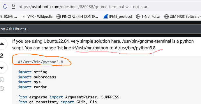

Some more change I did was I rebuilt, pytorch, trochvision, tensor flow for Python 3.9 than default Python 3.8 which was there as part of Jetpack 5.1.2.
It’s not a Jetson issue at all.
Google gives you:
Link your /usr/bin/python3 against 3.8 if it now becomes 3.9.
Thanks for the updates.
If I change the link to python 3.9 my tensor flow, torchvision and pytorch tools and frameworks will get effected as, I have built them against Python 3.9 and I need to maintain python3.9 as by default version on my Jetson device.
To fix this issue, I found one more solution as per below link, which says to just to modify the gnome-terminal python script and edit the first line to change the python version to python 3.8 as shown below. This worked for me.
OK, glad you found it.
