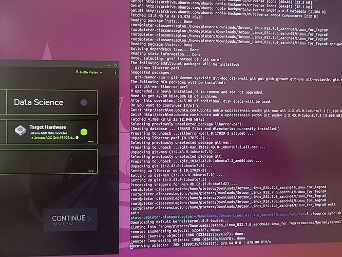

Okie dokie, we are getting there, at least our friend boots up and get recognised by die SDK manager now. (yay)
Just doing a source_sync to be able to select the SDK (in order to continue to Step2)

Hi ,
You don’t need to run source_sync when setting up the SDK. Instead, just let SDK Manager detect your device — it will automatically identify the correct JetPack version (e.g., JP5.x / JP6.x) that’s compatible with your hardware and download the necessary packages.
From your terminal logs, we noticed that your current BSP is R32.7.6, which isn’t compatible with the AGX Orin. For details on which BSP versions are supported by your device, please refer to the links below:
